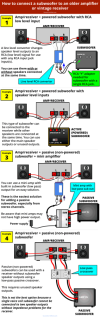

So, what do I need to look for compatibility-wise when I am looking for a sub? Does it need to be like matching speakers to your amp? As in, in my case, no less than 8ohm and no more than 50w or are subs a little different?
EDIT: I found an imagine that explains a lot for me (see attached).
As long as it has speaker level inputs, a level control and a frequency control, a subwoofer should be compatible. You don't need to worry about impedance; regarding power, you don't really need to sweat that, since it's not really comparable to the rest of your system. Most entry to mid level subs are 100W or thereabouts, but even if it's only 50W, that's not much of an audible difference, and unless you're running your system at max volume, you probably won't reach that.
It's important to remember that even though your main amp is 50W, it's almost never putting out that much power, even if you're playing it loud. At normal listening levels, you're probably not even using one watt (this depends on the sensitivity of your speakers, but it's pretty typical unless your speakers are really inefficient). The only time you're going to using close to your amp's power output is in musical peaks. If you tried to run it at 50W continuous, not only would you be deaf, you'd be producing close to 100% distortion whenever the music peaked, as the amp tried to produce more power than it was capable of. This is called clipping and is definitely undesirable. If you've ever heard someone blasting their car stereo and it sounds like blat blat blat blat instead of actual music, this is what's happening.
It's also useful to understand how the decibel scale compares with power output. A doubling in power output will result in only a 3dB difference in loudness. To get double the loudness, you need 10 times the power.
