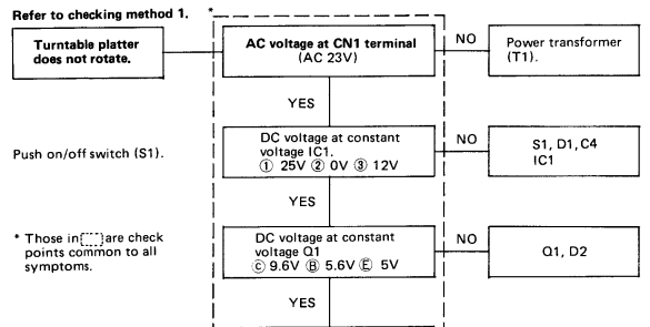

I looked up the service manual and began following the testing steps in it. When the turntable is off the transformer gives an output of 24v AC. This is in line with the service manual.

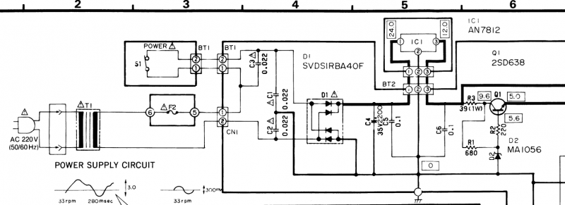

Turning on the turntable and measuring at the input of the rectifier (D1) gives a current of 19v AC. The output is around 16,5v DC. After the rectifier is a regulator (IC1) this gives an output of 16,5v, 12v and 0v (ground). The output of the rectifier should be 24v, 12v and 0v according to the service manual.
There is a resistor (R3, 38Ω) that is getting hot is after the regulator (IC1). This resistor is on the collector side of a regulator (Q1). The current over the resistor is 8v. Following the wiring diagram this should be around 2,4v. The regulator (Q1) is getting 2,4v at the base, 3,7v at the collector and 1,6v at the emitter. These values should be 5,6 at base, 9,6 at collector and 5 at emitter.
Does anyone have an idea what is wrong or broken? The replacements parts are pretty hard to find so I don’t really want to order replacements for components that aren’t broken. I feel like the transformer should provide 24v AC to the rectifier but I don’t know for sure. Also the hot resitor is getting to much power
