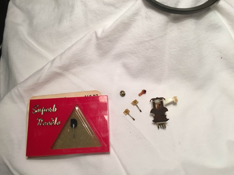

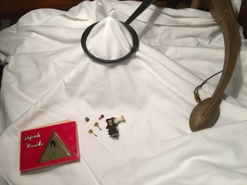

Thanks Orthophonic..husband here helping wife with Zenith #SFH2605...She ordered a 460-D7 replacement needle from Needlefinder.com but this is a two needle rotating stylus. Looks like what some call a Cobra Head. This is more than a single needle replacement job. There is a part in the head that seems to press and hold the two needles firm not really a spring as you mentioned...not to mention the rubber end of the 460 D-7 seems to not be able to attach to the needle holder of the rotating stylus. Do you know if anybody sells the entire headshell with needles or can rebuild ours? We obviously are not techno/audio-philes and I know only enough to be dangerous or when to trek to the oracle and seek knowledge. Hopefully the photos help.

I see the pics now, you have a Euphonics U-1, not E-1, that is the wrong stylus, you would need a 461-D7 for that cartridge. It is hard to see from you pics, but It looks like your cartridge is damaged or
deteriorated (the rubber yoke that the stylus rests in). So the whole cartridge (or head as you called it) might need to be replaced. Again, the Astatic 710 is the proper replacement cartridge (head) and
thevoiceofmusic.com has it in stock.
image.jpeg image.jpeg Bravo Gentlemen!! This beauty sounds amazing!! Thank you for sharing all your knowledge and helping keep this out of a landfill!
