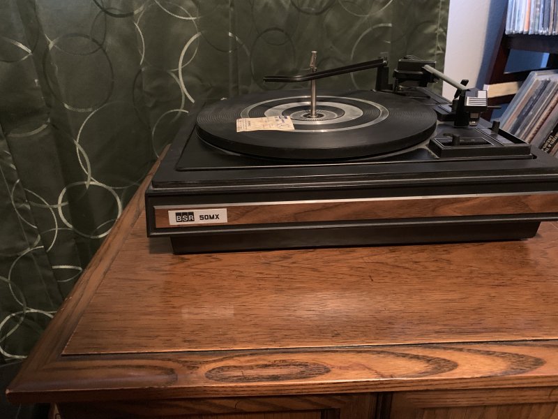

I recently bought this on CL for $25 and I was told the guys father used it for a bit when new but it sat boxed up ever since. It looks like new to me. I had to use a soldering iron to remove the platter and gear in order to clean it and oil it. It all looks good and clean but when I play records, it plays at an extreme volume and gets louder as the music gets louder, regardless of how low I turn the volume. I've tried a new needle and still the same. I bought this just to play 78's that I've collected but never have listened to.
Is there something I'm missing? My regular TT is a Pioneer PL-55 and sounds great. My Yamaha CR-2020 needs servicing so I'm using an 80's Marantz TA 100 which is ugly buts sounds great in the mean time. The BSR does not have a ground wire in case that makes any difference? I have not been able to find any info on this TT by the way.
Thank you in advance, Wally

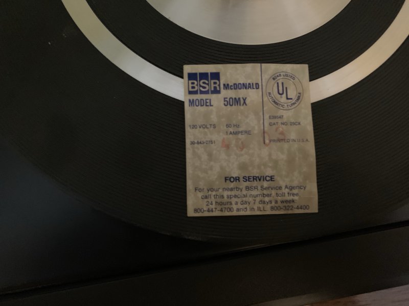

All this is over my head. Here are some pics if they may help? The cartridge is not removable. I'm assuming this was part of a stereo system which is why there's literally nothing online about it? If you're expecting me to operate on this, I literally need step by step instructions in bafoon English. I'm pretty sure my Yamaha has both phono inputs for mm and ceramic but it's not working for now....
