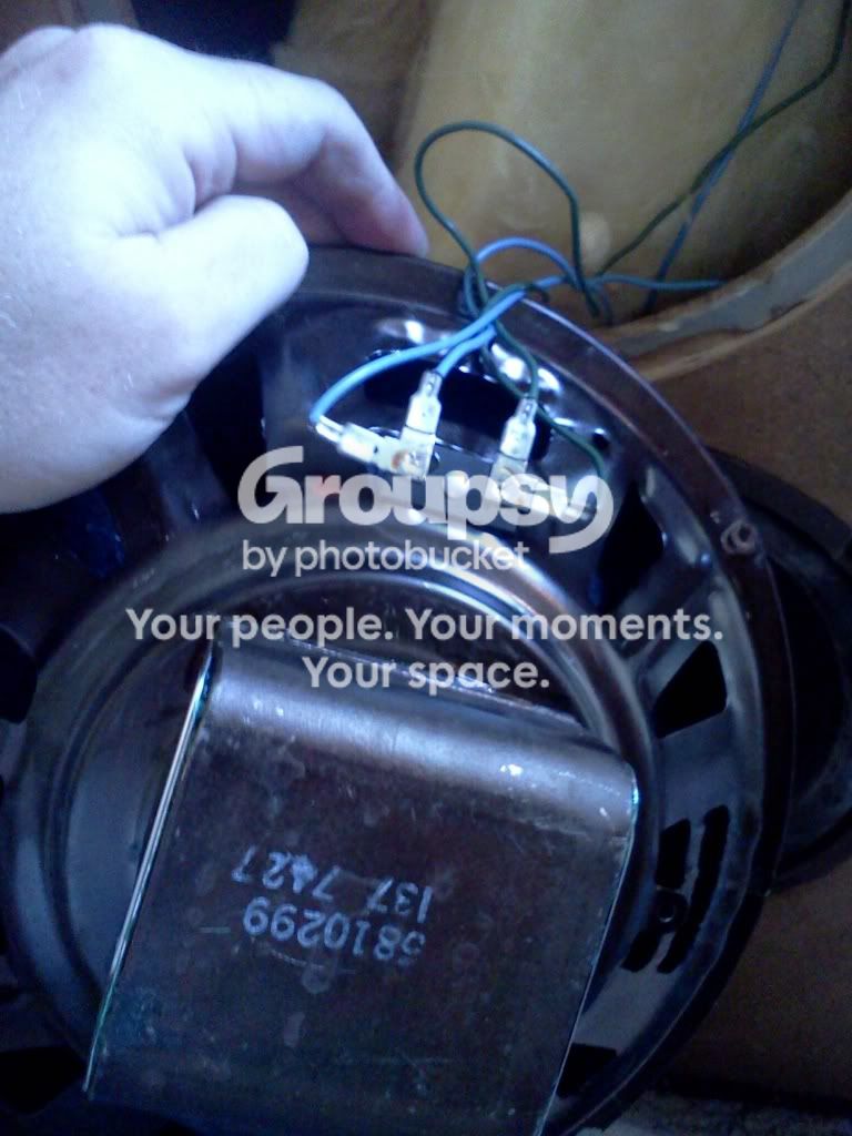

After noticing a channel imbalance and poor imaging, I found that I seem to have a blown upper 10" driver in one of my Model 10's.
Using a multimeter, it looks like continuity is good from the terminal to the voice coil.
I've switched the driver to my other working Model 10 and it doesn't wake up there either.
The butyl surrounds are solid, and the signal passes through from the upper 10" to fire up the lower 10" properly when all terminal wires are attached.
Anything else I should look for? What's my next step forward? I know "qualified technician" and "replace the driver" are the best answers, but I'm utterly penniless at the moment and am interested in learning anyhow. I appreciate any suggestions.

Well, I spent some time with the driver today. Looks like the spider is broken in a few places. Should I be able to get continuity all the way to the voice coil wires as they're going onto the coil cylinder? I didn't have any luck.
Tried hooking the driver directly to an amp. No response.
I'm interested in the idea of disconnecting the upper 10 in the other one. At least I could get imaging back and I think it would still sound better than the Model 7's. But it looks like if I disconnect any of the terminals, I lose continuity to the lower woofer and it shuts off. Any idea how to do this easily?
Well, I see two ways to do it.
For either option you would leave both wires connected to ONE side of the woofer. So, in a sense, you will be using the woofer as a terminal strip for one set of wires. Then...
Option 1: Disconnect both wires from THE OTHER side of the woofer and move the "live" wire to connect the lower woofer back up. This probably gives you a leftover jumper wire for each cabinet. You'll want to keep said jumper for when you get the dead woofer repaired (and not lose them like I would).
Or, option 2: Disconnect both wires from THE OTHER side of the woofer and "simply" connect them together. I might tend to consider soldering the backs of the spade connectors together. Or soldering a short jumper wire to/between each of the connectors. Whatever I did would be in such a manner that the solder does not get near the connector itself.

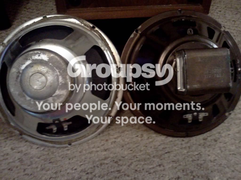

Well, a solution fell in my lap this weekend. I picked up a quite nice pair of Model 8's for $25 off CL. They're beautiful, and I enjoyed listening to them for a couple hours. Strong bass and great vocal presence, although I was finding the gritty high edge of male vocals overprominent.
Regardless, their beautiful original 10" butyl surround woofers were too much to resist. They look identical to the original Model 10 woofers from the front, but the magnet is different. The black one with the rectangular magnet on the right is the original model 10.
Sounds perfect so far. Great to have the Tens back in action!
I had some JBC 320W automotive 10"'s ("Just Be Cool") that I put in the 8's for the time being and they still sound perfectly respectable to my ears. Maybe if the original 10" gets fixed the drivers can all go back to their proper homes.

My 10's have the woofers like the round one on the left. I had to make the extra 4 holes.
