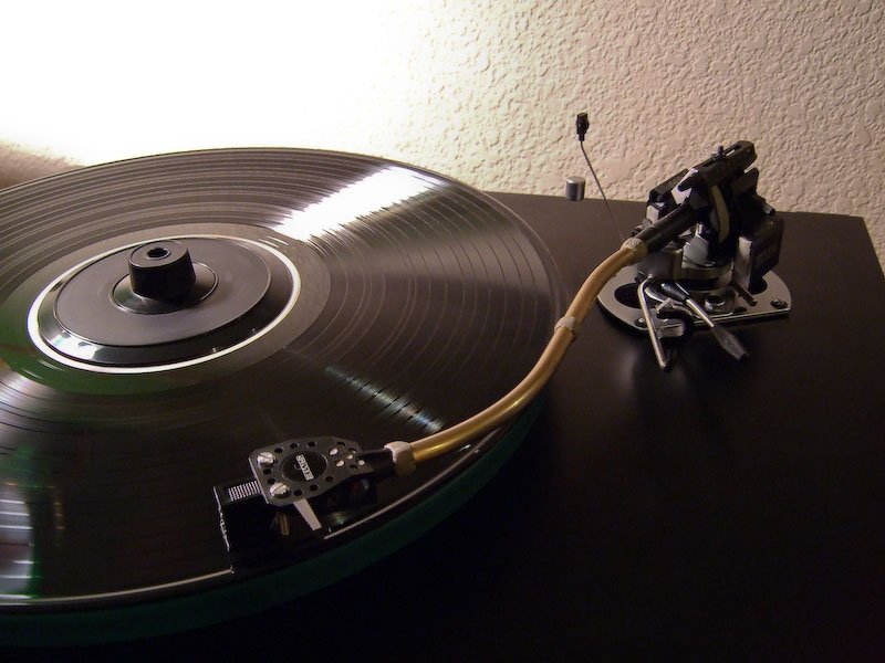

Nat is correct; the original Planar series Regas came out in the mid-to-late 70s. I got my Planar 3 in 1981; at that time, Rega was not making their own tonearms, and tables distributed and sold in the U.S. did not come with an arm at all, or even a hole drilled for an arm. The dealer had to cut a hole in the plinth for you to mount your arm of choice. Popular arms at the time in the U.S. were the Grace 707, and the SME 3009 Series arms; I mounted a Series 3009 Series III on mine and have had it ever since.
I don't think Rega made their own arm until 1983 or thereabouts.
Regas hold up incredibly well over time. The photos you see here were taken about a year ago, when the table was 27 years old. I've replaced the motor in mine with the motor upgrade, and have installed a GrooveTracer Reference subplatter, which made a huge improvement in the performance, the noise floor was markedly lower with the subplatter upgrade and the table became significantly quieter.
