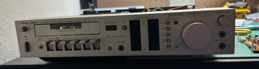

This might be more verbose than needed, however I have been attempting to diagnose an odd issue during the restoration of an interesting Harman/Kardon HK705 tape deck. Cosmetically it is perfect, and so far I have replaced all the belts (which I would suggeest to never attempt to do). I have playback working flawlessly, and was able to test for all types I-IV with no issue. However, in order to get this back in full operation, I need to be able to record! Here is the obligatory tape deck in pieces currently on the bench:
This is where the interesting part comes in. Right channel records perfectly, however the left channel only seems to be outputting highly distorted, low frequency information from the input/music I am attempting to record. Before you jump to conclusions, please do not tell me to DeOxit, if someone tells me to Deoxit I will flip (just kidding, but oxidation on any of the switches, including the long switch that switches between play and record mode, was dealt with thoroughly).
