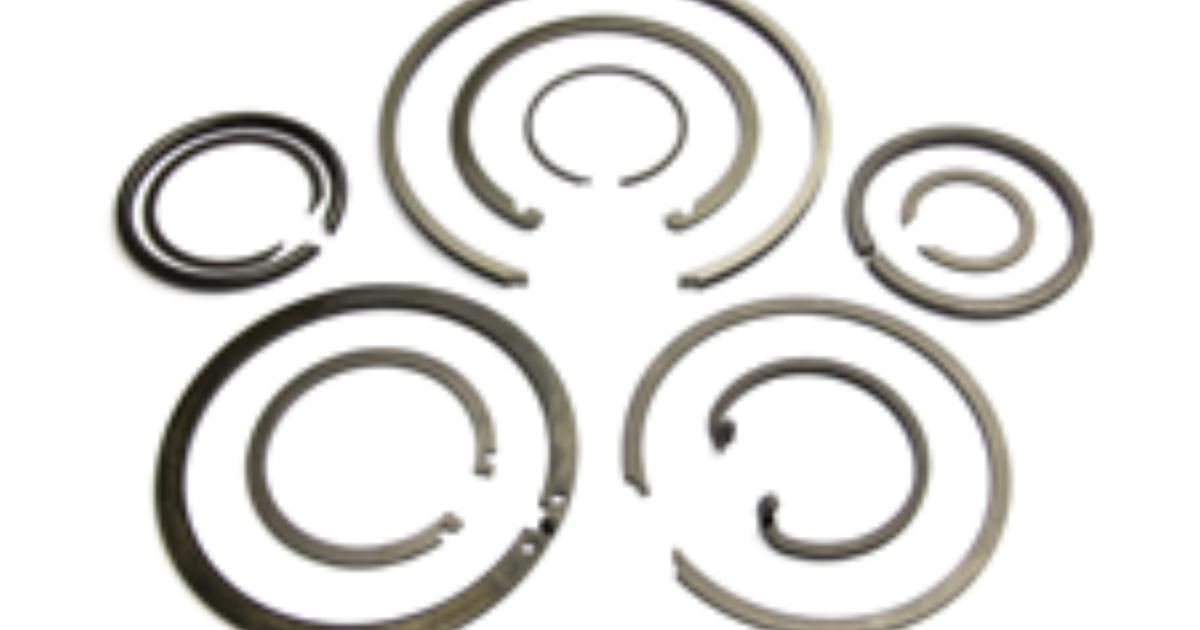

Is there some kind of tool to hold the spring down? The compress the spring-put in clip could not at the factory hold the spring down while shanghaiing ones family members to insert the clip.
Not talking about the pliers that spread clips to remove and reinstall.

Not an e-clip tool. Not sure how I can take a pix. When you put a spring on its shaft, the spring has to be compressed so its e-clip can be inserted. No tool to hold the spring compressed?
How big in diameter is this C-clip? For small ones (like less than 3/8 inch in diameter), I put an oversized washer on top of the spring.
This allows easier finger gripping and compression of the spring with one hand. Now, just push the C-clip onto the shaft's indentation.

You were born with the tool. It's your index finger / fingernail.
That's what I've been doing OR having a second person do while I put the c-clip in. One wrong move and the spring is forever lost in that place where springs hide. Index finger nail and thumbnail actually. Each time I say to myself that can NOT be the way they did it in the initial assembly.
how much tension is on the spring?
press down spring with thumb and middle finger of left hand, set clip in groove with right hand, hold in place with left index finger. grab pliers with right hand and lock the clip.
Can you use a bread tie to hold the spring compressed; then slip it over the shaft, install retaining clip, then untwist bread tie, releasing the spring?
Tried that too. For me what happened is the spring tension made the tie slip around so one side of the spring is compressed, the other side not. It looked like the guy who squealed on the Spartans in the movie 300.
