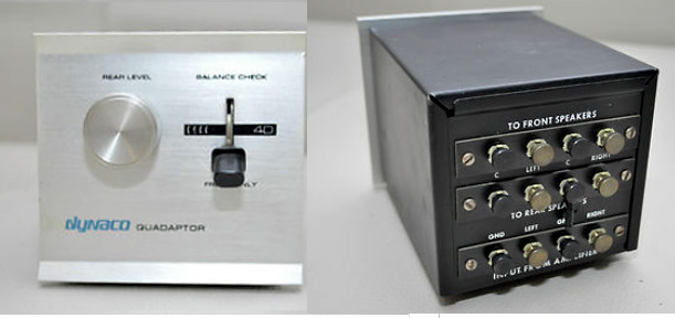

Wanna have some fun, keep an eye out for one of these ...
Gives you two fully isolated and balanced sets, with bonus Hafler effect to add ambiance.
I believe you failed to mention where the speakers will be located. Two sets in the same room would benefit with the above box, but a remote set in another room would suffer as it wouldn't be pure stereo there ...
