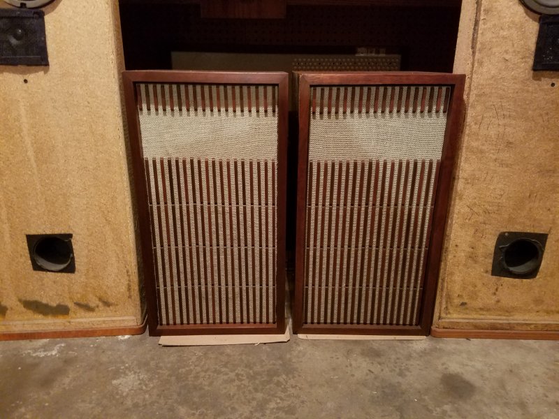

I agree, your speakers are the weak link. The Pioneers listed above are very nice. There are a lot of good sounding speakers out there that won't bust your budget if your willing to hit up thrift stores and garage sales. Over the past year, I've bought KLH Model 6s and Model 32s, Baby Advents, Polk Monitor 30s, Bozak LS200s and Jensen Model 1s and didn't pay more than $30 a pair for any of them. Some of them needed new surrounds, a couple had cabs that needed work and I put new caps in all of them, But if your willing to do the work it's not expensive. To me that's really the fun of this hobby, hunting for diamonds in the rough and bringing them back to life.
