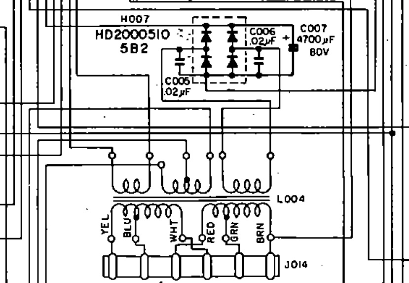

After a lengthy absence, going through some of the recapping threads here -- apparently the interest in these four pole electrolytic capacitors happened after I last worked on my 2230. I had planned to go through and make a few changes -- mostly some more film caps for coupling in place of low value electrolytics, some more Silmic IIs in the power supply -- but I was also interested in trying out one of the four poles. It looks as though the Jensens are unobtanium now, so I'll probably have to go with Mundorf.
But I did some searching here and elsewhere online, and I'm not having much luck finding a clear diagram for installing one in a simple full wave bridge circuit -- i've seen photos and text descriptions, but I'd rather work from a diagram.
Here is the stock filter capacitor wiring:

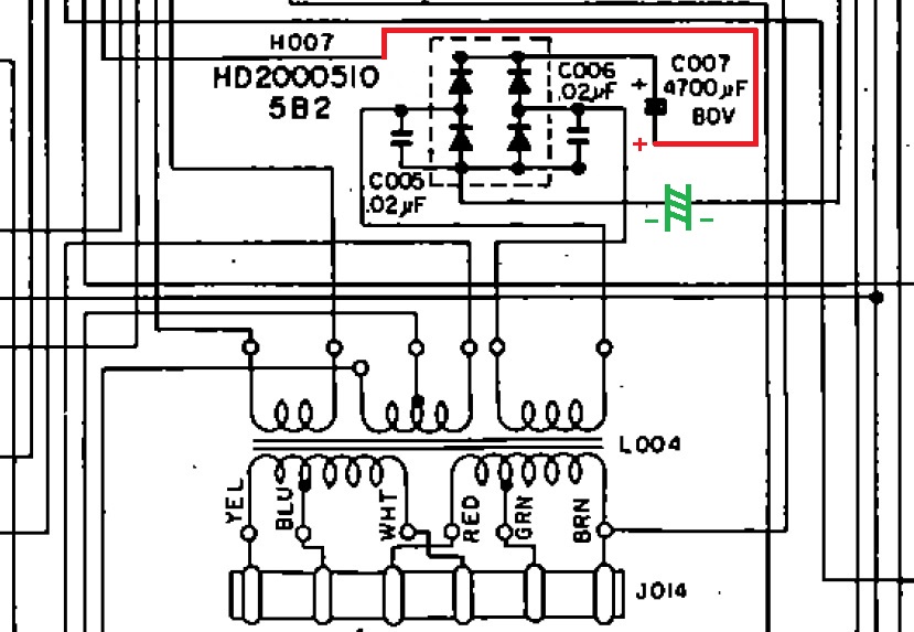

I took a guess at how I thought it might be wired in after reading some about how they operate, but I'm still unsure, and not comfortable guessing about things like this:
Could someone who has done this (@patfont ?) critique/assist?

c007 is the filter capacitor .for it to do its job it has to be wired the same as the original diagram .
putting a capacitor inline with the ground will only cause problems . well i can't see it having a good outcome .
ok, + in would be from bridge, + out goes to the amp boards.
Going from memory there are 3 (red/or/orange) wires going to the stock cap Pos side, so the one from the bridge goes to Pos In, the two others (one for each amp board) go to Pos Out.
Hope this helps!
Thank you so much for the prompt, detailed response -- the runs that were intimidating me the most were for the ground side, but I'm assuming now that these also follow an in/out flow from the bridge as well.
