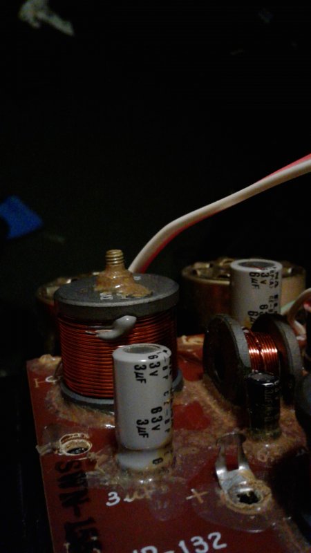

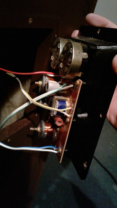

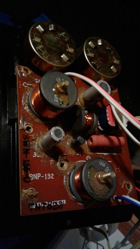

I started working on the bad speaker first so I can learn with this one. I removed the crossover this week, I have the SWN-155-0 version.
HM, sounds like you have made some progress. Those caps on the xover don't look too bad.
Not sure replacing will change that "forward" sound much. New caps might even make them even more forward.
Have you tried turning down the HF controls to see whether you can get a less forward sound?
You should be able to cut both the mid and tweeter quite a bit. Super tweeter has no control! So if it is causing your problem, your only option would be to bi-amp and simply "push" the woofers harder via woofer amp volume control.

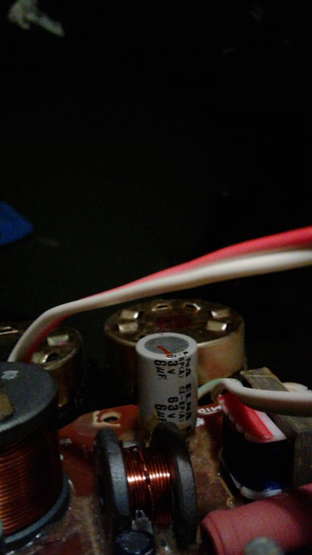

Hi Jerry,
Yes I have the same feeling that switching caps will not make enough of a difference ...but I am willing to try it as a learning experience. These caps are 63V, 6uf and 3uf ....Maybe I can find caps with similar specs. (I will need to buy caps, a soldering kit and a six pack of beer.)
Regarding the controls in the back...I have turned the HIGH down and the MID up in both speakers and they have very little effect at the listening position that I use them. I have read posts online that say that the controls in the back rarely work. Not sure if the parts are rusted or what...I am planning to inspect them and test them this weekend.

Was there a reason you did not replace the .3 uf cap and the 8 ohm resistor?
Hi, great question. I did not buy the parts for the Super Tweeter yet, first because of cost (I try no to spend more than $100-150 in hobbies each 30 day cycle....just to keep myself in check) and second because I was nervous to ruin a $15 dollar cap in my first rebuild.....I need to get my soldering skills up to speed and I was hoping to gain some confidence with the other caps first .....I will probably replace the 0.3uf cap eventually but I figure that I could work with the frequencies up to 12K first which are the ones I will immediately notice the improvement on....Regarding the resistor, I was not even considering replacing that one....my assumption was that resistors don't really go bad compared to caps ...I measured it to ~8ohms and that was good enough for me.....How much influence do you think a new resistor will have on the performance of the ST? what type of resistor should I replace it with?
It won't cost that much. I think I may have spent less than $40 for 6 Dayton Audio Grade Poly caps and two Dayton resistors. Before and after:IMG_0187.JPGOld Caps and resistor
