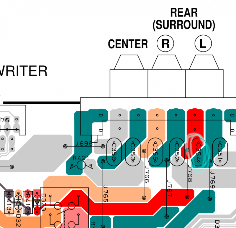

But right now I am actually thinking that it isn't the STK (IC302) that is the problem after coloring the paths for the IC302 rear left channel.
How would you experienced people approach this troubleshooting - am I on the right track?
I have made some blue squares in one of the attached files (schematics.pdf). These are the only areas that I can see that could cause continuity for the rear left channel.

Keep in mind that if you are measuring at the speaker posts with unit powered off then the protect relay will be open
so no connection to the STK, possibly a short near the spkr post, eg, strand of wire. Also, don't measure resistance with
amp powered on, if you did this, sparks may fly...
As my DMM was acting up, I tried connecting my component tester over the speaker terminal.
Top image is showing a low resistance value - this is for the rear speaker L terminal.
All other speaker terminal ports indicates as a capacitor.
This is leading me to think that it actually is the capacitor C354 that is causing the problem.

Should also inspect the L-Rear speaker posts for any broken wires/strands shorting to GND.
Also check wiring inside the case, thinking more likely a wiring short than cap failure
A lot of screws later I could flip over the main PCB and de-solder C354. Already after doing that I could measure that there was no continuity.
index.php
Checking the capacitor confirm that it's not behaving as a capacitor anymore.
