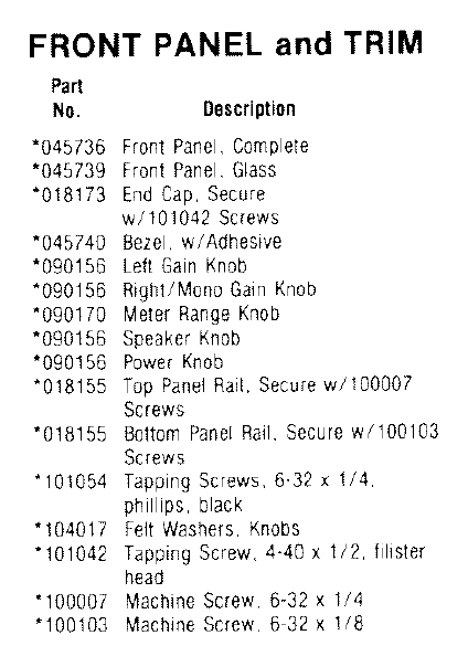

As to the knobs, you have the correct set. "A" is American sized and "M" is Metric. The Meter switch is the Metric sized shaft - the others are American.

Here are the parts for the MC2255 front panel:
The 090170 is a Metric-sized knob - different from the other 4.
Larry
Thanks everyone! I checked the stems and knobs with a caliper and for my amp the meter selection stem is the metric one, the other 4 are all the same. The knobs are all the same height - my bad picture. The center of one has come unglued, but I have it.
