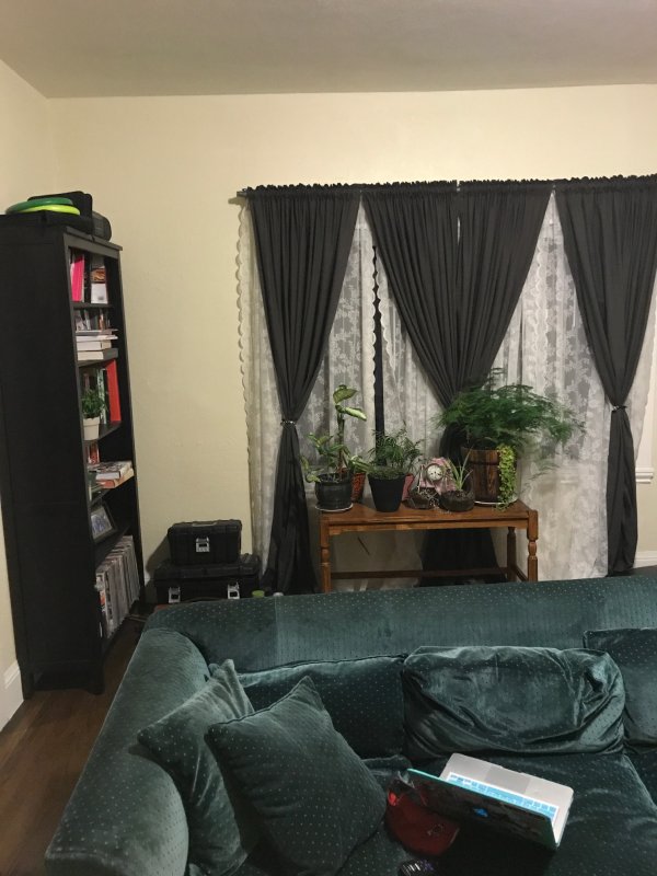

So I've inherited my fathers stereo. Its large. kind of intimidating. and I'm a noob. I'll put up some photos of the room and the system. or at least the parts of it I have. Im located in the Bay Area in california and work in a kitchen, so my funds aren't all going towards this, but I would like to listen to something at a reasonably loud volume and have it sound perfect.
I think I went about it right by attaching "your media" but please let me know if you need any more information. I don't even know how to hook this stuff up or what I need. or if the room is too small. can or would you even want to hook your tv up to something like this? or is that overkill? [GALLERY=media, 12279]IMG_0333 by xtiandeath posted Oct 26, 2017 at 11:39 PM[/GALLERY]

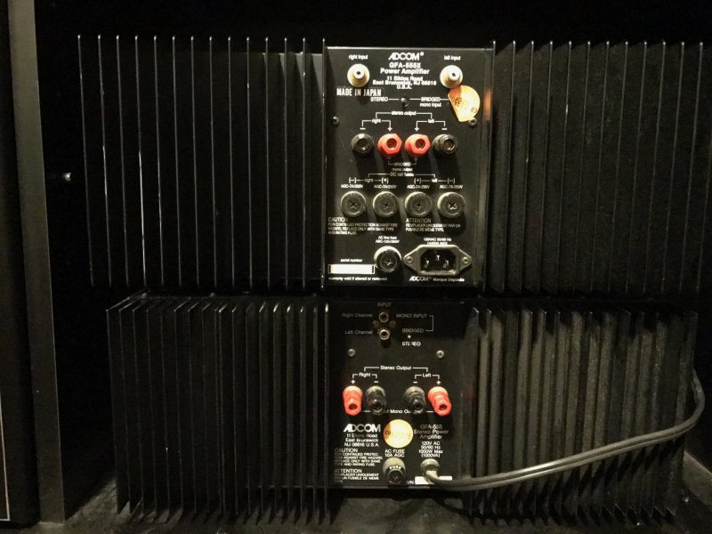

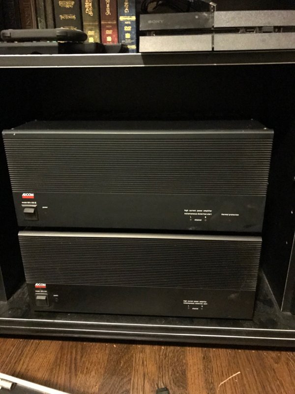

You only need one of those Adcom GFA-555 power amps to get started,does'nt really matter which one either.

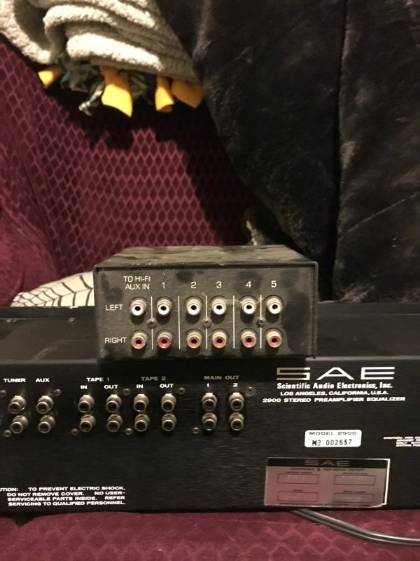

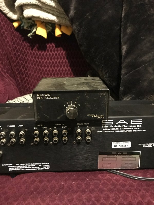

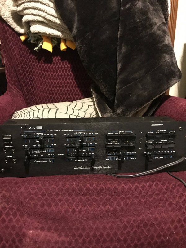

That SAE piece is the preamp,so you're gonna need that too.

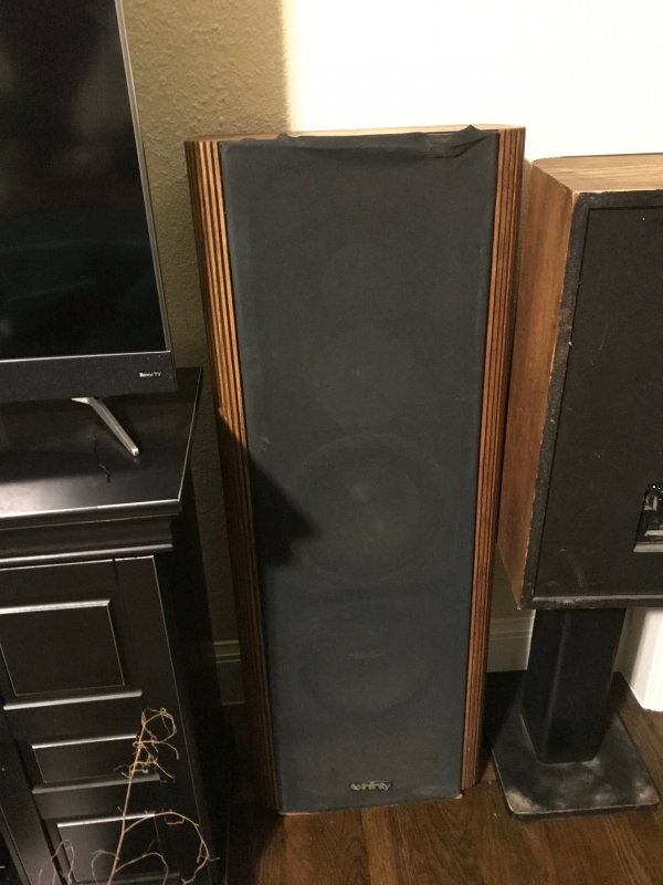

And of course you'll need one pair of those Infinity speakers (your choice here).
That SAE preamp is used to connect the Adcom power amp to any sources.
It's also controls the volume,selects the source,and tone adjustment.

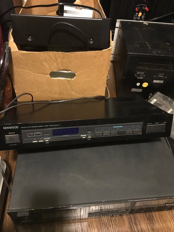

Sources I'd use here would likely be the TT -and/or- the Kenwood tuner.

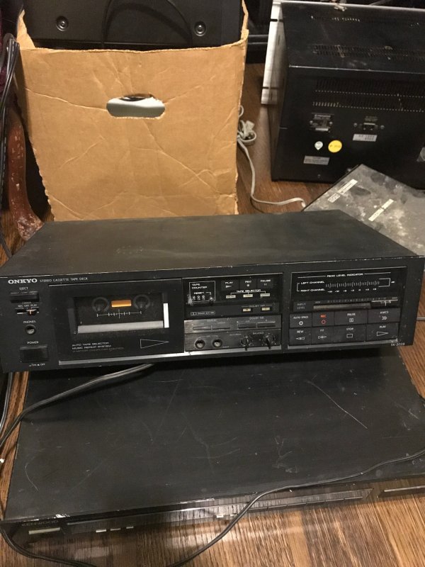

I would'nt mess with the cassette deck for now,odds are it needs fresh belts anyways.

The smaller input selector box would only be needed if you run outta inputs on the SAE preamp,and for now that's not likely.
So you can ingore that for now as well.

From there it's pretty basic,look at the back of the SAE preamp and study which of the sources connect to which inputs on the preamp.
Note that these inputs are marked for left and right channels,so make sure these are the same on both the source component and the preamp.
The output on the SAE preamp gets connected to the Adcom power amp's input,again making sure the L & R channels are the same on both units.
Then you connect the speaker wires.
You need to make sure the + terminal on the power amp's speaker output is connected to the + terminal on the speaker.
Same is done for the negative speaker wire(s) for each channel.
Then and only then you can connect the power cables and fire it all up and see if it works.
Now many here are gonna advise you get all this checked out before firing it up,and that's not bad advice at all.
Especially seeing as those Adcom power amps dont have speaker protection relays.

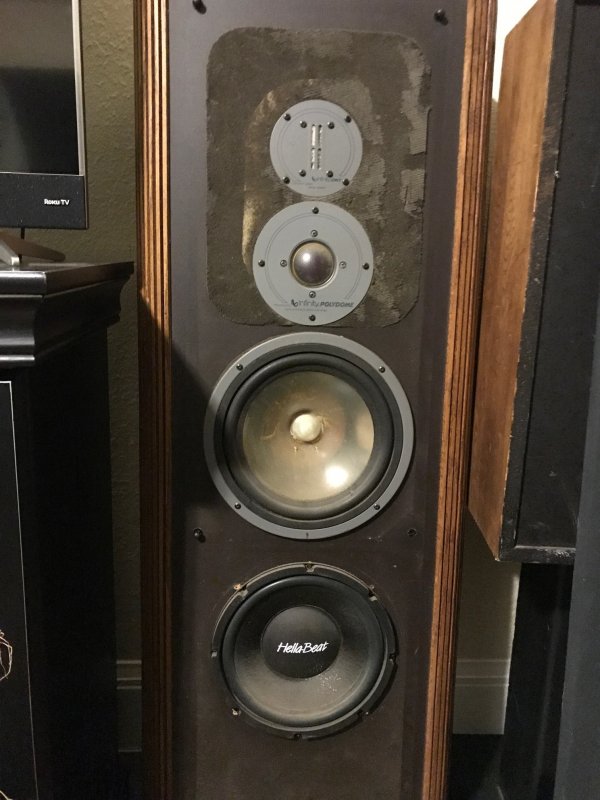

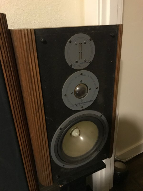

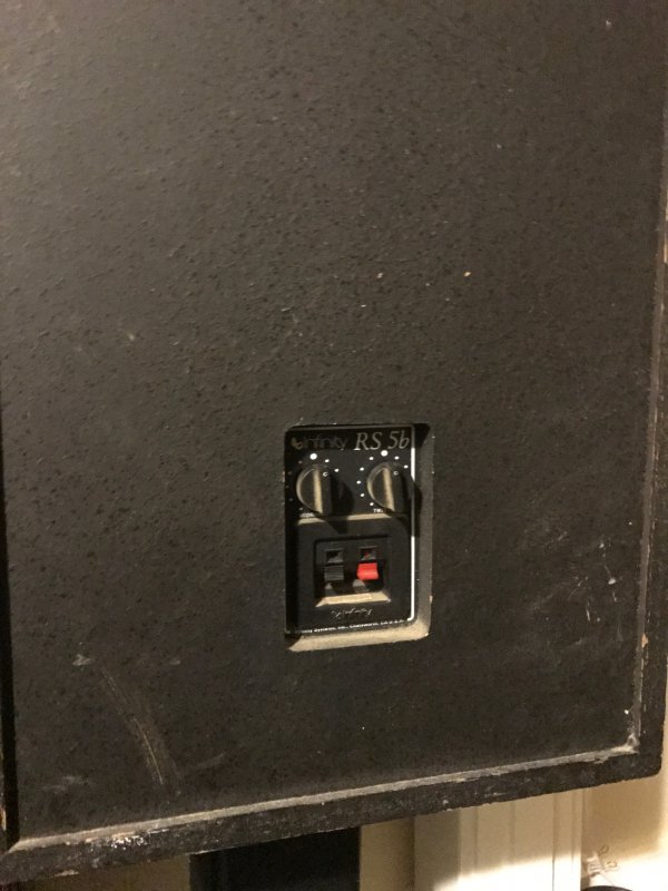

I'd recommend that you use the RS5b speakers to begin with, the RSIIIb's have a car stereo woofer where a real Infinity woofer needs to be. That can be sorted out when you can locate a proper replacement and have the funds to purchase it. The RS5b's are really good speakers, I had a pair several years ago and they could get loud, real loud.

I'd recommend that you use the RS5b speakers to begin with, the RSIIIb's have a car stereo woofer where a real Infinity woofer needs to be. That can be sorted out when you can when you can locate a proper replacement and have the funds to purchase it. The RS5b's are really good speakers, I had a pair several years ago and they could get loud, real loud.
I noticed the "hella beat" in there and thought it odd. I'll definitely start with the 5b and maybe start the refurbishing/replacing project some other time.

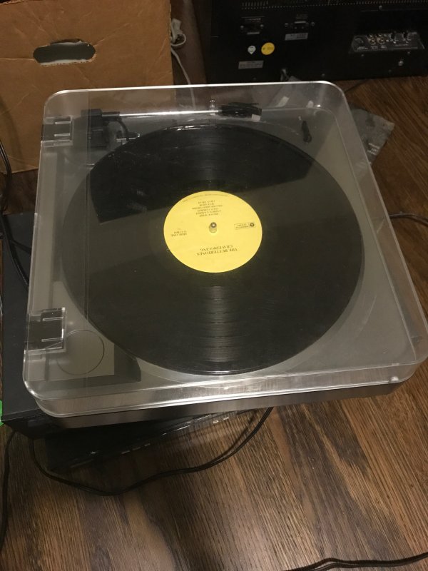

If you like vinyl, set up the TT next to the preamp.
That SAE will be a bit of trouble to learn, not to get started but to understand all it can do because of the parametric equalizer offered instead of tone controls. But the right side of the unit will be easier to learn and use and that is the part you need to get going.
Grab the owners manuals from sites you need to join but they don't send you anything, just join and download.
Hifi-manuals.com has
Adcom (both amps)
SAE 2800 (a parametric equalizer, not a preamp) this will explain the EQ section of your 2900

http://jims-sae-site.com/manual_schematics.htm has
SAE 2900 but requests a dachshund rescue donation
The Onkyo TA-2028 (is that right?), can't find a manual but other cassette deck manuals may be enough to get that knowledge.
Don't know the turntable but can tell it is not up to the performance level of the rest of the gear.

The cables you need and hooking up some stuff and you are ready to see what you have. I'd evaluate each component. Caution with the Adcom amps. If they don't work they can destroy speakers. I'll let someone else address this lack of speaker protection relay in these amps and what to do about it or how to check it before you do anything. If you know they work, give em a try. Otherwise, I would be figuring out how to check em before hooking them up to speakers.
Need a cassette to test that machine, thrift stores can have these. A 7" reel of tape and a 7" empty reel to test the Pioneer so they can wait.
Don't know the model number of the Kenwood tuner but the operation of a tuner isn't hard. Plugged in properly and with some kind of antenna, even a single chunk of wire hooked up to one of the 300Ω connections should get you some stations.

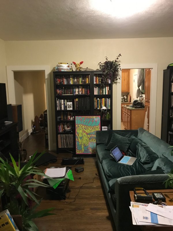

so just to start. the pair of rb5, the equalizer, the adcom power amp gfa555, an onkyo CD player, an auxiliary cable for phone play(cause who doesn't like playing dj), and my audio technica crap TT. I wish I had a better one but money is tight and I need a place to put it before I go get a really nice one.
actually gonna go to a couple thrift stores to see if I can find some sort of stand or something today. I know the chair is in the way of everything but I have nowhere else to put it. it sounds good. when you press the buttons on the SAE preamp it gets static. I don't know what the levers do on it either. It doesn't seem to change the sound really while playing music. at least not noticeably. the first thing I played through was Type O Negative- World coming down. It can get very loud.
any advice?

I wrote a whole damn thing about how your SAE works and when I clicked on one of your pics, it got eaten before I could post it. :dunno:
Find the IN/OUT or TONE/DEFEAT switch on the left side and turn off the equalizer section for now. Listen to your system 'flat' for awhile and see how you like it, then decide whether you need to mess with tone controls. This is actually a cool and very flexible set of tone controls once you learn how to use it.
