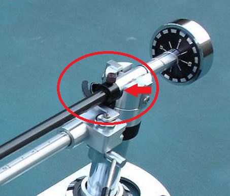

I've got an Infinity Black Widow on hand and I'm trying to figure out what this piece actually is. I hope we have some experts on bored that can identify this part? I checked the manual and it has no mention of this part. It also doesn't show up on very many pics of the tonearm. It seems some have it and some don't. As delicate as this tonearm is. I don't want to futz anything up. Can someone please help me out on this one? :dunno:

The original had a carbon fiber shaft with that collar and set screw. At least that's what it looks like. The newer ones are made from graphite and don't have that collar. The graphite shaft also has a demarcation in the middle.

I think I have that same version, a small rod goes through that collar piece and extends down into the oil dampening tray below.

That appendage is the paddle. It is part of the viscous damping system. There is a trough that is meant to hold a viscous fluid such as silicone . The paddle, which is attached to the arm tube, passes through the fluid in the trough as the arm tracks the record. The viscosity of the fluid causes some minor resistance to the quicker motions of the arm, allowing the cantilever in the cartridge to take greater loadings.

In this context, carbon and graphite are the same thing. There may be two different versions, but they're both going to be carbon graphite of some sort. It's most likely a pulltruded rod.

Is there any particular specification for the dampening fluid? Or will the kind from the RC Hobby Stores work fine?

I have no info on any factory specified damping fluid. I have used an automotive differential lube with good enough results. As to trying different silicone fluids as used in RC racer suspensions, I guess it is possible to go too thick and sticky, but I would not know where that limit might be. It could be fun to experiment.

I think most people use the RC Shock fluid. Something like 30,000 or 50,000 CST if I remember right.
EDIT: The KAB damper for the SL-1200mkII uses 60,000 CST fluid. I might try somethng a bit lighter for the Black Widow simply because it's a more delicate, lighter tracking arm and you're likely to be using more compliant carts on it than you'd use on the SL-1200mkII.
