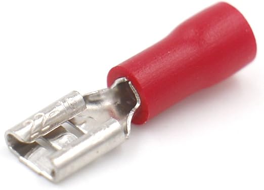

My .2 Infinitesimals have putty where the EMIT wires pass through the baffle.
For a while I had one Infinitesimal that had noticeably less EMIT output than the other. Both measured the same.
Finally discovered some of the putty was in one of the wires crimped end, removed and cleaned the putty from crimped part and full output was restored.
Kind of an oddball problem, took me a while to figure it out. Still seems hard to believe that was the problem but the cleaning restored full output.
Putty was in the metal end (not the red end) of this type connector that pushes onto the EMIT terminal.
