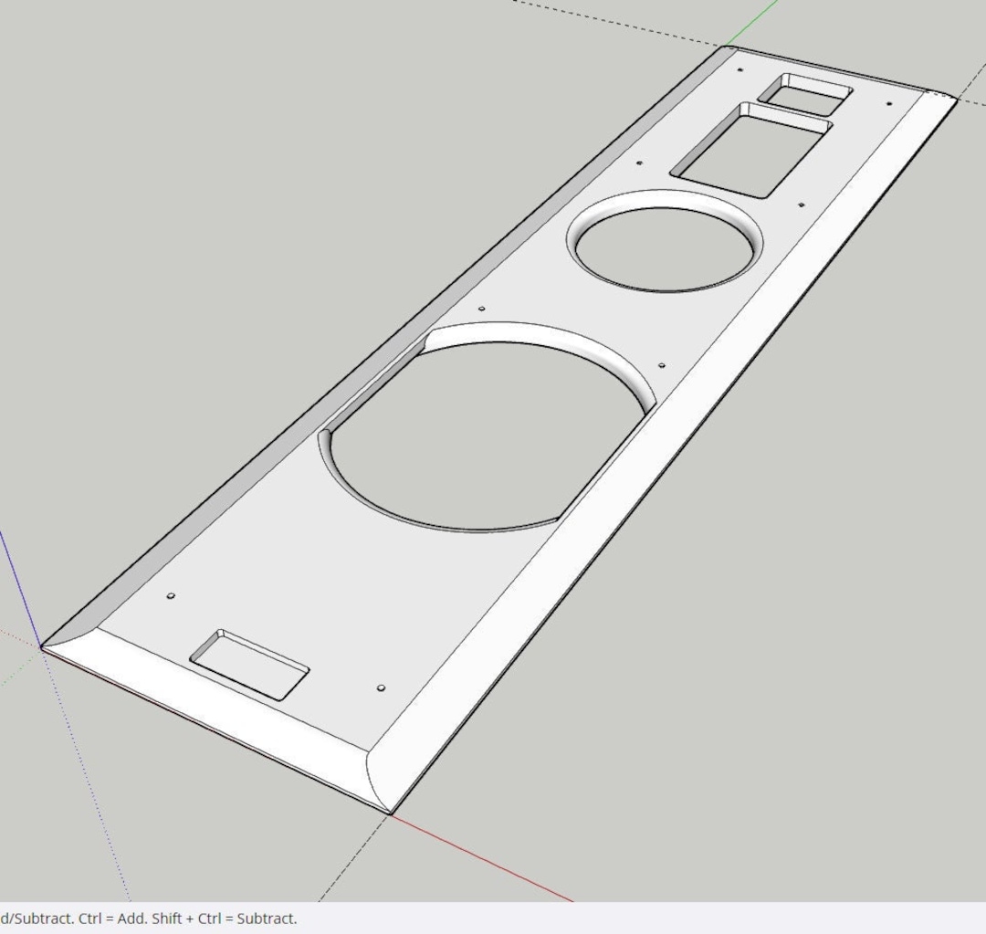

I've made tangible progress in the design now. The main model of the speaker is more or less done; ready for fitment comparison with the grille model when I complete that.
I didn't make the rear of the speaker as accurate as I can, nor have I added the top cap yet. But it's a good enough representation for now.
The mid-bass and woofer are simply represented as cylinders extruded to the height of the cap screws, for clearance analysis in the assembly with the grille.
Okay, so I've made some nice progress. I have the speaker modeled a bit more realistically, and the original grille design completely modeled. I've yet to do the modifications to have a tight fit around the EMIT and EMIM as previously mentioned, but I'll be doing that next.
I pulled the little logo plaque out of one of my old grilles, but I'm not sure if I'm going to have a spot cut out for it in the grilles. The actual Infinity logo is a separate piece from the rectangular plastic holder - probably because the close fit around the logo would have been too expensive to mill out of the grille back when these were made. It would be neat to model the exact shape and cut that out of the grille instead - but I'm not sure if I can measure it accurately enough to look good.
Here's some screenshots of the progress:

In SketchUp, my friend and I created a full-scale 3D model of a grille for Renaissance 90 speakers, which can be used to cut the grille on a CNC router, a large 3D printer, or by other means. If you manage to make the grille based on this model, please share the manufacturing process and the result. Thanks!
It'd be interesting to see how closely our models match. Mine is done in Solidworks, and is ready to go using the factory pegs and logos, though I might buy new pegs and adjust the grille to match.
I'd love to cut the Infinity logo into the grille directly instead of putting the factory plate in, too. I'm wary of trademark infringement though if it's sent out commercially.
Did you use my measurements or take your own?
