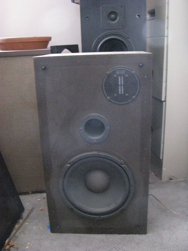

A while back I picked up a pair of Infinity RSa's, and was just looking for more info. The pictures I found are of a standard two way, while my pair actually has a port on the front.
Does anyone know if there were multiple versions of the RSa?
I'm kind of surprised that a company would put out two quite different versions with the same name.

No, what you have is a heavily modified version that's not really much of an RSa any more except for the tweeter. The woofer is not an Infinity woofer, and who knows if the crossover is original. All RSas had sealed cabinets with poly woofers. In fact, I'm reasonably certain that Infinity didn't make any ported EMIT-based speakers at all until the Kappa x.1 series in the early 1990s.

Port should have been put in the back and down real low, not sure why someone would install one on the front. I bet the original X-over is in them still or the EMITs probably would have been smoked by now
Not original, but it could still sound decent if a)the modifier chose a good quality woofer compatible with a ported box of that size; b) the modifier chose the port size by modeling that woofer in that box; c) The modifier properly calculated that the replacement woofer would be compatible with the original crossover, or d) built a new crossover properly calculated to take all variables into account. I'd listen to them for a while before deciding what to do.

EMITs need to be crossed over fairly high. I used to have a pair of Qas (the predecessor to the RSa) and found them to be somewhat lacking in midrange because the crossover frequency was really too high for the woofer (the Qb fixes this by adding a midrange). If the replacement woofer doesn't go up high enough you're going to experience this midrange loss as well (and possibly worse)..
Thanks again. Swechsler, I haven't listened to them recently, but I'll check it out again. My recollection is they sounded muddy, which might be because of midrange loss. It's just a little weird, because I would have expected modifications to be a little more obvious if done by someone who didn't know what they were doing with tools -- scuffs, or sloppiness around the ports, which I don't see. I was disappointed at the sound, having heard fairly good things on speakers with the emits.

Is that one of your speakers in the first post?
If so, that's the right EMIT for the RSa.
Round, blackface EMIT.

Could it have been an RSb, and some wannabe Arnie Nudell took out (or more likely, destroyed) the midrange and replaced it with a port? Does the crossover have a model name on it? The boxes are the same size and the drivers are the same, or in your case were... There's a pair of mids on Ebay right now, cheap, maybe this could be a little conversion project seeing as someone has kindly cut the holes for you.

The speakers have backplates on them with the Infinity information (RSA) so unless this are complete frankenstein speakers made up of odd parts, I don't think so. I believe I have a single RSB somewhere so it's something to check with the positioning of the port. The backplates have two attenuators on them, I recall.
I'm going to take another listen to them, confirm that they sound lousy, then probably part them out. Then I'll get into them to get the parts, and see what's inside, which should tell me what is in there, where the woofers are from, etc.
In any event, my fault. I bought them without knowing too much about the line, BUT I know enough that ports aren't generally put in the middle of the baffles at the factory. I love these audio mysteries.

It's kind of a drag if the woofers are crap. However, if everything happens to be genuine (or of decent quality worth keeping), would it make sense to remove the port tubes from the front, cut wooden pieces the size of the holes, and then use them and appropriate sealing, to bring the things back to their original configuration?

I doubt it. The midrange driver on my RSb's have a wider opening than what that port looks to have.
