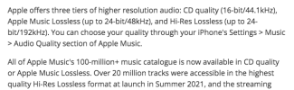

Uncompressed CD bitrate is 1.4Mb/second. The best lossless compression can get that down to about 40% of original, so 256kbps would be considered somewhat "lossy" compression. However, I have long maintained that given a good compressor and a reasonable bitrate, the vast majority of people (myself included) will not hear a difference between lossy compression and no compression. So is that hi res? No, it's not. Of course, the Nyquest-Shannon theorem says that anything above the CD sampling and bit rate is superfluous. Obviously some poeple will disagree.
LG100: It can't be. I.e., if you do the math, linear PCM with 16 bit quantisation and a sample rathe of 44.1 kHz in stereo requires 2 x 2 bytes x 44100 /s = 176400 byte/s. Typical lossless compression formats would compress that to roundabout 50 % at best, so let's assume 88200 byte/s or respectively 705.6 kbit/s. So lossless compression at 256 kbit/s would appear pretty unlikely. And no, not high-rez either, as 16 bit / 44.1 kHz (L)PCM nowadays isn't considered as high resolution audio.

The term "high-resolution" as applied to digital music originally referred to bitrates higher than CD (more than 16 bits, more than 44.1K sampling rate, or both). Effectively, the term meant higher resolution (that is, higher than CD, which up until higher-resolution recording became available was the standard for high-quality digital audio).
However, over the past five years or so, the streaming services have co-opted and re-defined the term to include CD bitrate.
In any case, it must be lossless to be considered high-resolution.
