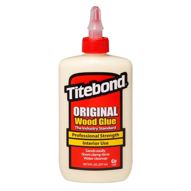

Not only do I use glue for assembly but I run generous portions down the inside seams to block any air gaps ( ported or not ). Both sides of joints need glue. DIY guys always say "you can't have too many clamps" and it's true. I use original Titebond and not the quick set up glue as you will need to make adjustments and it gives you the time to do so.
