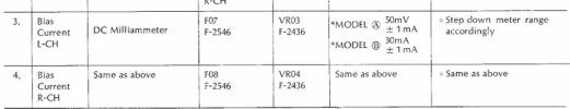

If it is like almost every other Sansui, you measure amps (current) after removing fuses, not voltage.
Does that mean F07&8 50+V is normal? Now I see the service manual showing a little confusion. Model A(9090) is 50mV but model B(8080) is 30mA. So you mean service manual is error?
