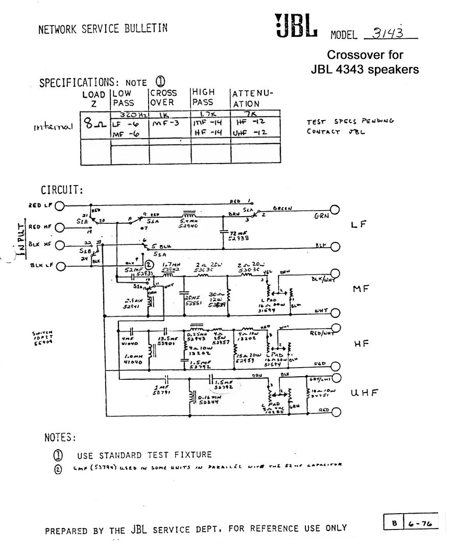

After spending a really long time on the internet, on forums and using AI researches from Gemini, Chat GTP and Claude, none could return an ORIGINAL JBL 3143 CROSSOVER SCHEMATICS!
There's a couple of schematics versions floating around but they're either modified ones or handwritten on a piece of napkin. There's no conclusive response, none seem to be the the authentic original.
It it the main reason for my post, short on opening the speaker and extracting the crossover in order to figure out the written values that have probably faded by now. I just want a part list parts to place an order. Once I have the parts, I am going to dive into the box to do all the work at once.
I hope that somewhere a nice soul is listening and is willing to share this information with the me and the forum or in a PM. I would be SO greatful and also make a donation for this forum. I need to know the number of capacitor used in the circuit and their original values. Sounds simple...
