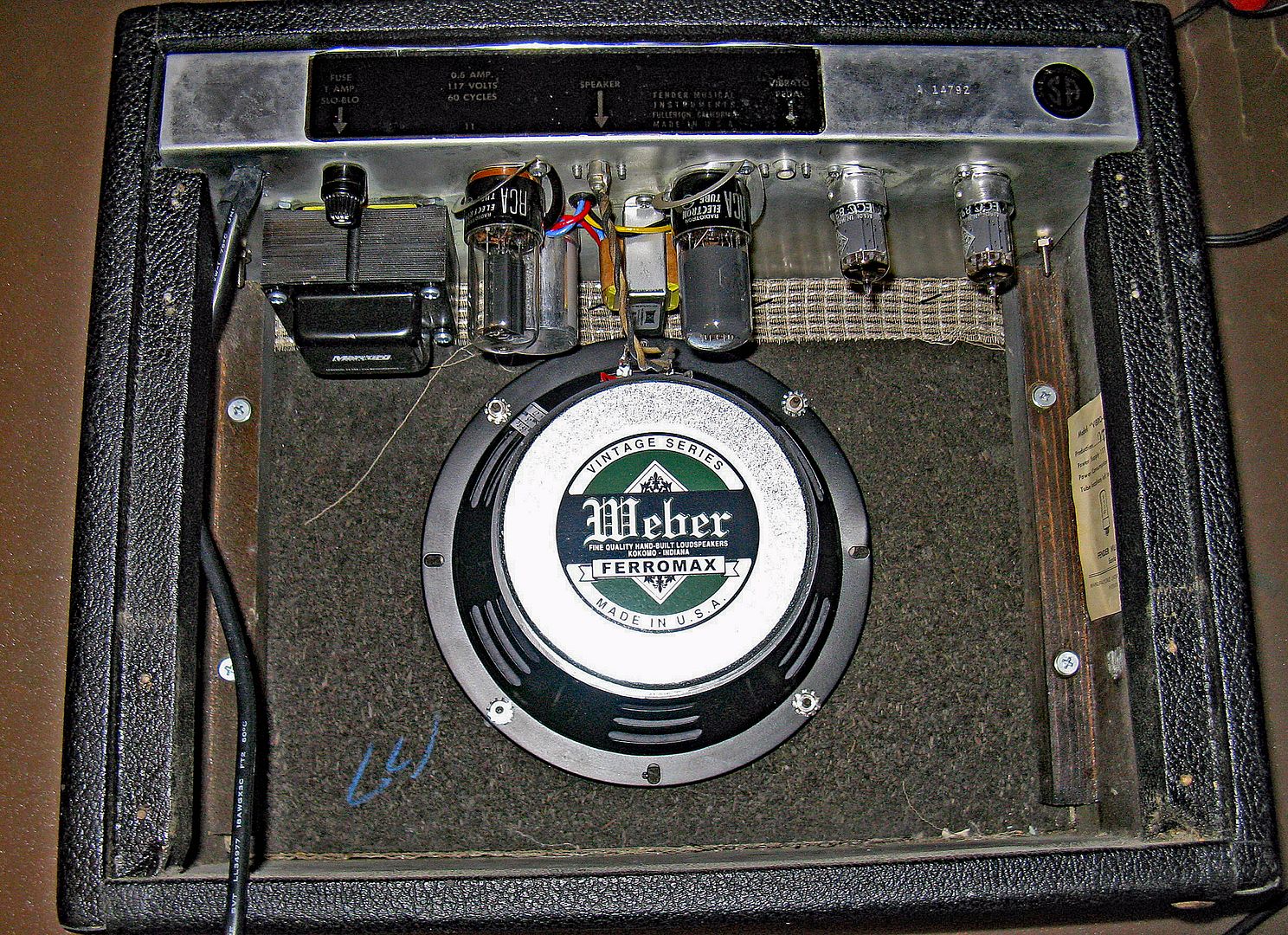

Know anyone with a Fender Champ or Vibro-Champ sitting around? I have not heard a Champ with a D208. But, it's supposed to be quite good. I run Weber speakers in my Champs and VCs.
https://rocknrollvintage.com/products/1965-fender-vibro-champ-w-jbl-d208-serviced
As long as the Champ has an 8 ohm output transformer (the original Fender transformers were made for the original 4 ohm speakers, in the Champ), then this should work well.
Using an 8 ohm speaker on a Champ with the 4 ohm output transformer will work- but it will lose quite a bit of output level. And that can be a problem, when you're only talking about 6 or so watts to start with...

I'm usually running my Champs close to "dimed" or "12" --- on older tweeds. Using the volume knobs on the guitars to tailor the sound. Full blast, there isn't too much difference in the volume level between 4 and 8-ohm speakers. The 4-ohm may overdrive, a bit sooner in the volume level. Those old transformers in the Champs (in the blackface and silverface era) are pretty tough cookies. Most of the earlier tweed era OPT are not. I like the original Triad transformers, but the ones Fender put in the early Champs were really not made for full output, all the time. They were built for students (like most of the tweed era Champs). Finding replacement Schumacher transformers is getting a bit tougher (read $$$).
I've been using Mercury Magnetics Toneclone output transformers for fixes with blown output iron. They are pretty darn good. Esp with modern speakers, like Weber alnico. I would LOVE to try that JBL with a Merc Mag, fully restored Champ! :)
