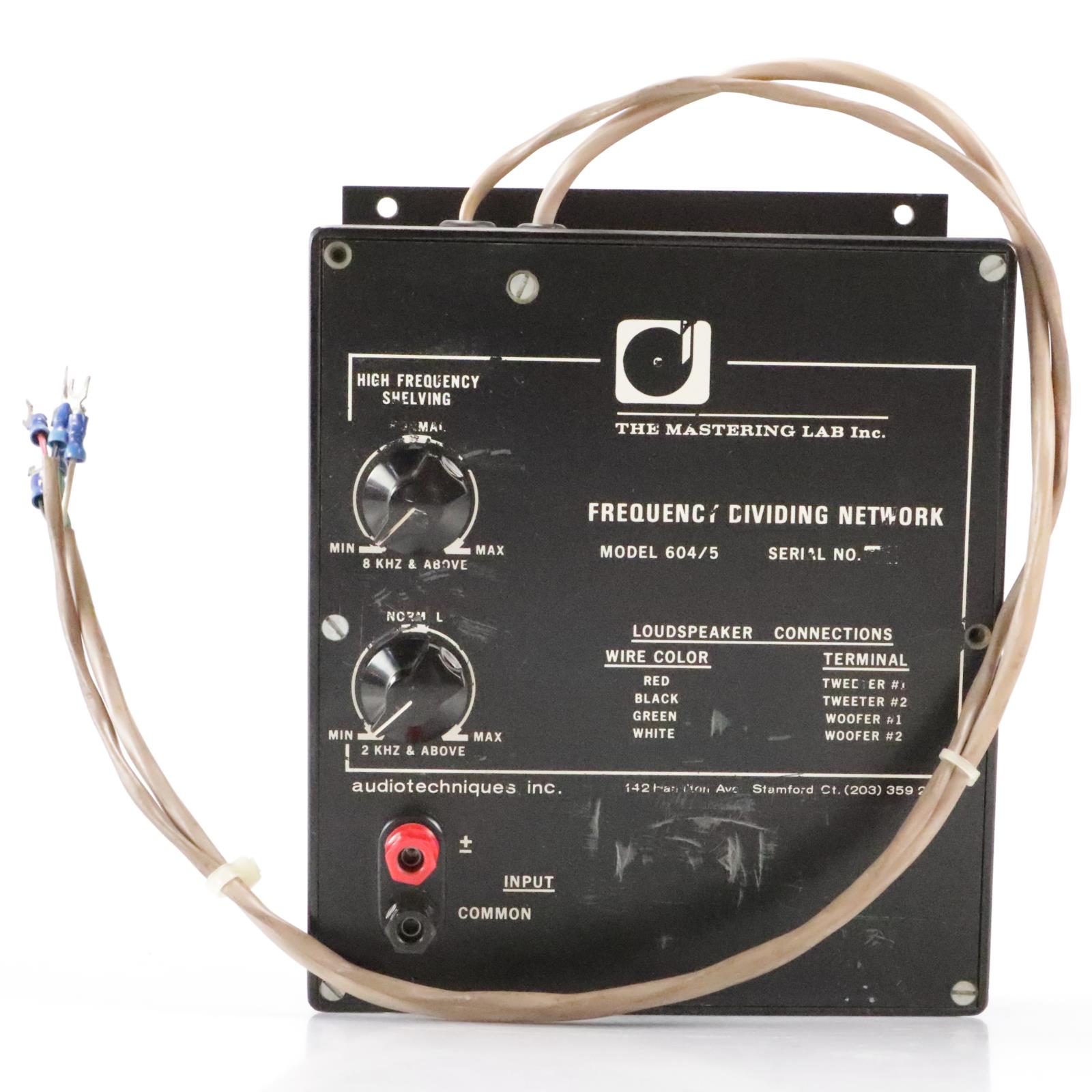

One-off, AudioTechniques, Altec 604E2 Super Big Reds most probably made by The Mastering Labs. These included a custom-made one-off electronic crossover and a pair of one-off passive eq units that go between the horns and their amp. I think they were done by The Mastering Labs because when I look at the passive eq networks between the power amp and horn:
And I look at The Mastering Labs passive crossovers I see the same frequencies being addressed except that the eq units offer more options for adjustment:
