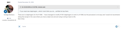

I wish I could find Bob Crites details on fitting the K55V diaphragm into the K55M. I know he said don't it.... but I am a pretty skilled DIY'er. I have a fairly well set up garage full of tools. I don't have a milling machine. but do have TIG welders, die grinders, etc. Not sure exactly what tools would be needed, but I think I could make due.
Maybe email Crites. There was a documented tutorial, but they took it down. Maybe they still have it for the asking?
