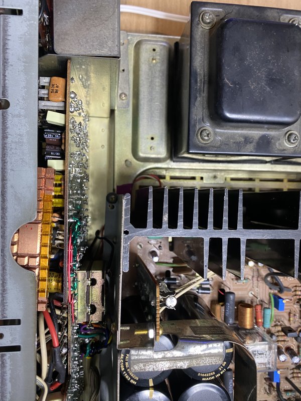

Hey guys,

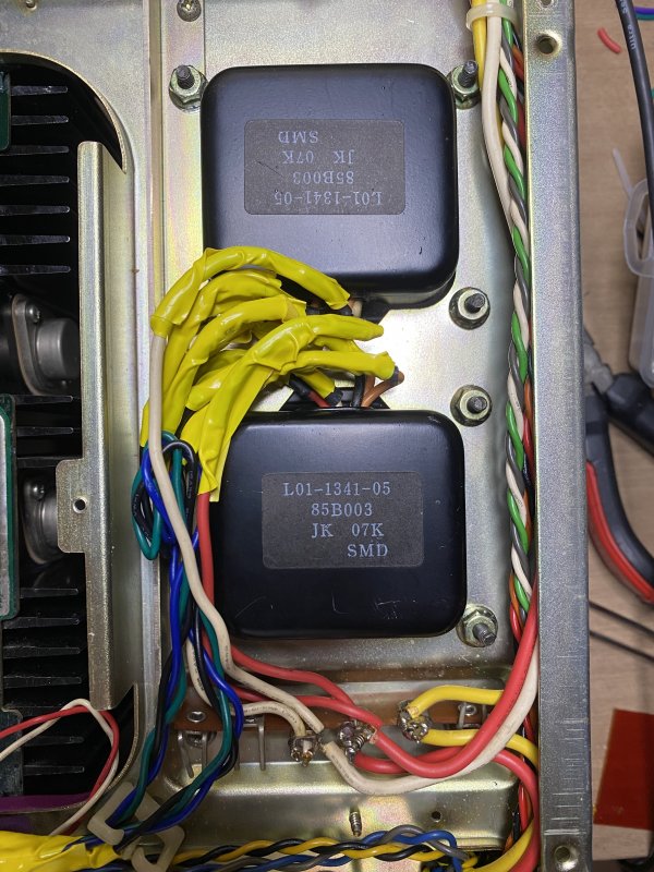

There were in fact 2 hums at play: a 60Hz and a much smaller 120Hz, combined together.
The 120Hz was caused by he diodes Di1 and Di2 which were burned by the heat of Qi13 and Qi14 I replaced all four (Di1, Di2, Qi13, Qi14), the surrounding resistors, and the surrounding capacitors, and the 120Hz hum went away.

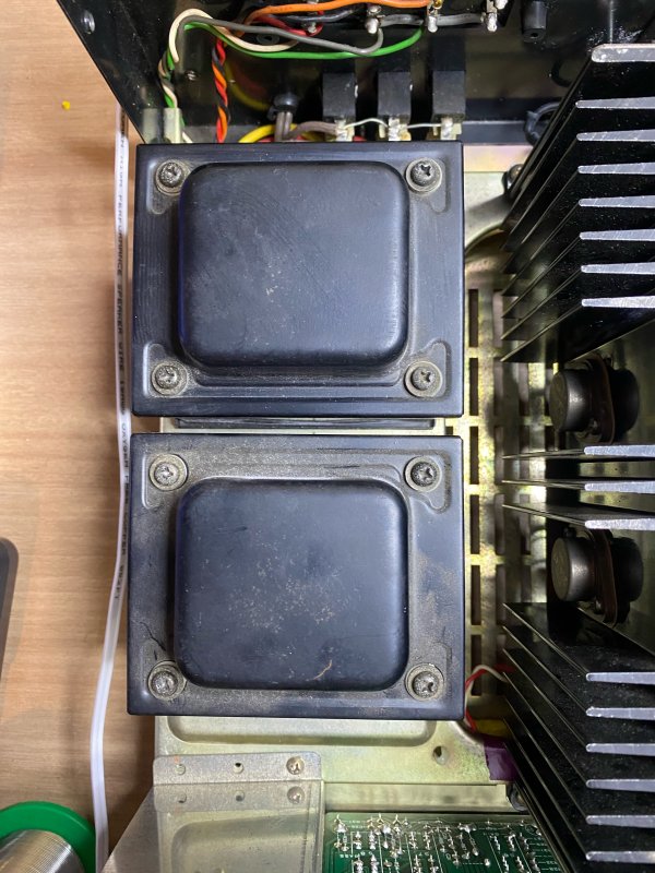

The 60Hz hum is induced by the power transformers. Someone has replaced the original Kenwood transformers as far as I can tell and when I move them around, the hum comes and goes. If I move the transformers outside the case, with longer wires, the hum completely goes away. Cool, but not practical, LOL!!
Two questions:
- Is there a heatsink solution for Qi13 and Qi14 to prevent things from burning up again?
- What are good transformers to put in to avoid the induced Hum (or is there a change I can do to the layout of the wiring to cut it out?)

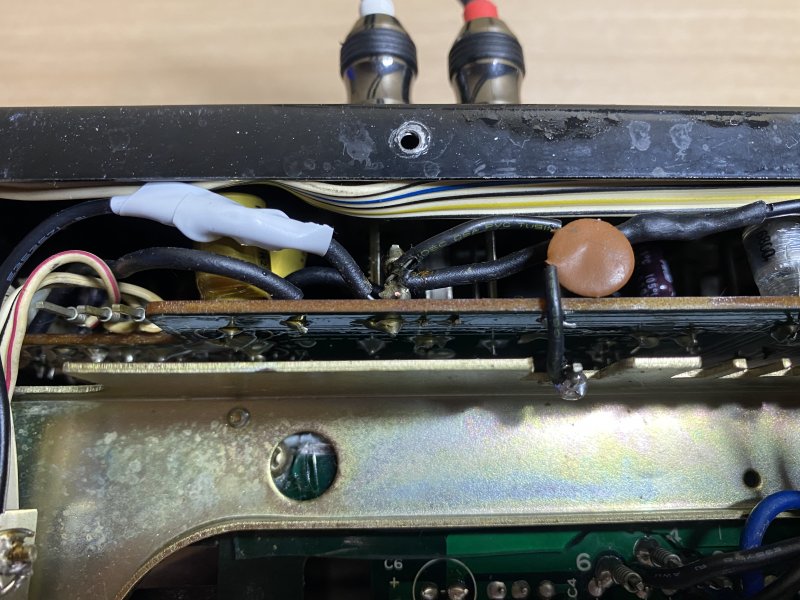

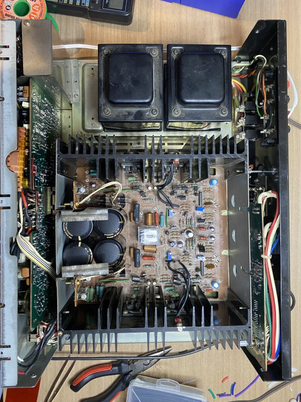

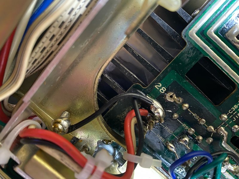

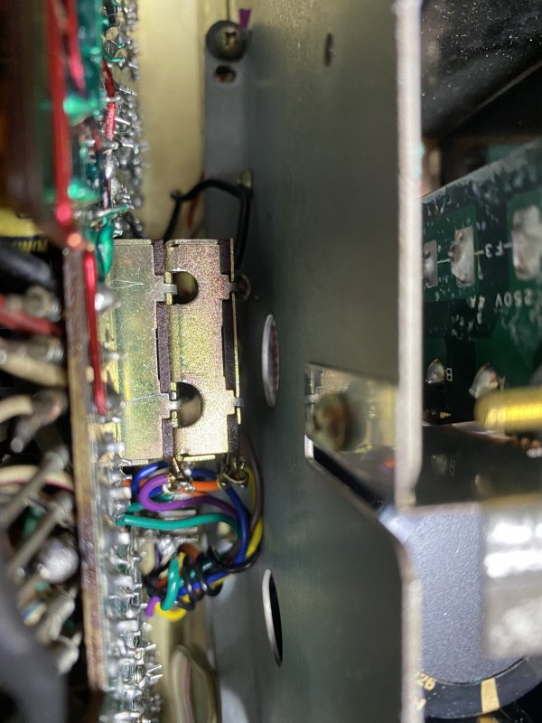

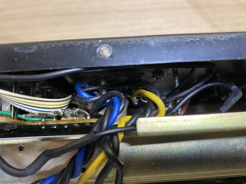

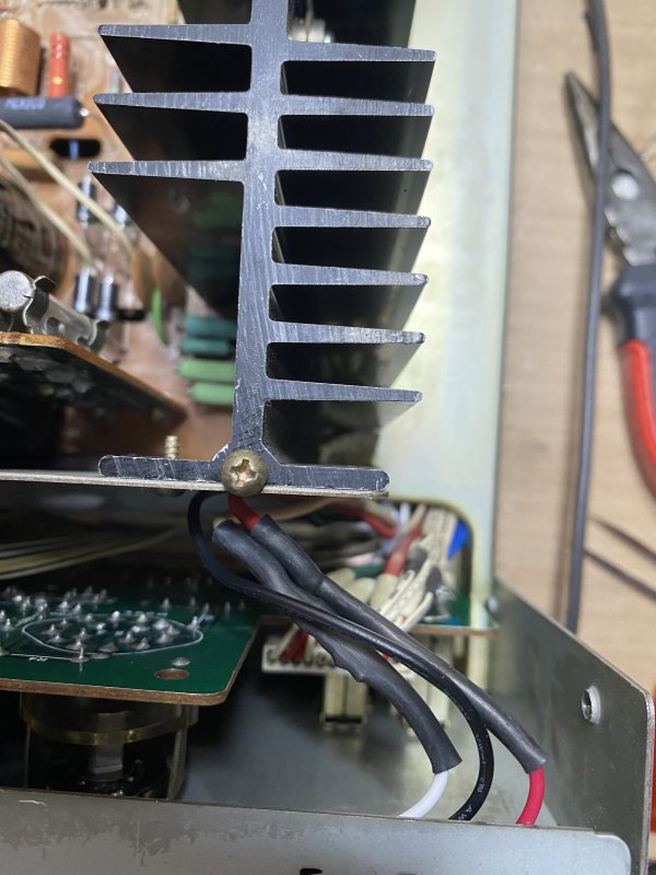

Hey,
Bugged my friend who gave me the amp, and he had kept the original transformers, and warned me that they hum.
Put them back in, and now the amp is a LOT quieter, except the transformers physically hum (sigh) and the amp still hums, but very very faintly. Also, when I crank the volume to maximum, I can hear a radio station.

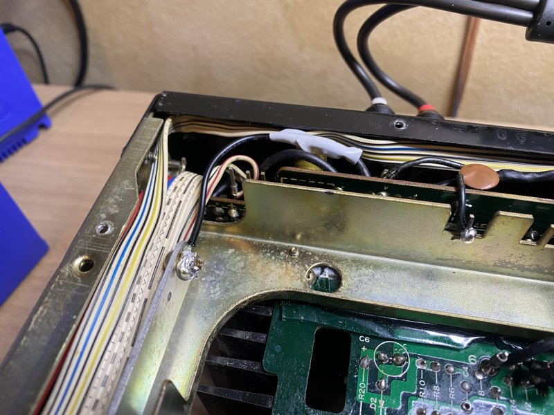

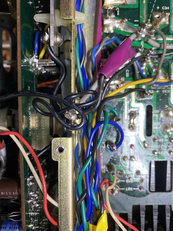

There is definitely a grounding issue somewhere. I double-checked all the chassis screws, and they are all soldered/tight.
It is the same as previously, when I plug in directly to the power amp's input, very very quiet, and very nice. When I plug in via AUX, the pre-amp adds the Hum (and Radio station).
Attached are various pictures, more than happy to take something more precise :)
Thanks!
Antoine
As far as I can tell, all ground points are correct, unless there are some missing that I am unaware of. Would be awesome if someone had a KA-8100 to compare all the ground points! :)
What if there is nothing connected to the inputs? still noisy/ hear radio?. Today, there are tons of shitty battery chargers (cordless power tools), that make so much RF noise...
