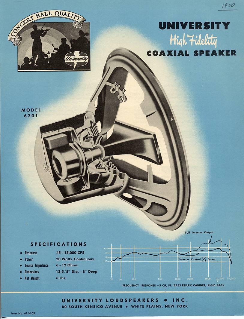

The cut sheet has a nice cutaway view of the entire internal layout.
6201-1.jp

Putting a university 6201 in both. One of the university 6201 seems to have an issue with the high frequency adjustment: sounds fine when the pot is turned all the way up, but highs cut out completely if the dial is turned at all.
Is this a problem with the pot? Or a capacitor problem?
anyone know the spec of the original pot and/or a suitable replacement?
thanks.
Speaker is rated at 6-12ohm/20w - I have some Dayton L-pads that didnt work out on anotehr project that are 8ohm/15w--is that a close enough match?
I may re-order anyway for longer shaft length, or else it is going to be a creative install.
All help with wiring/specs appreciated.
