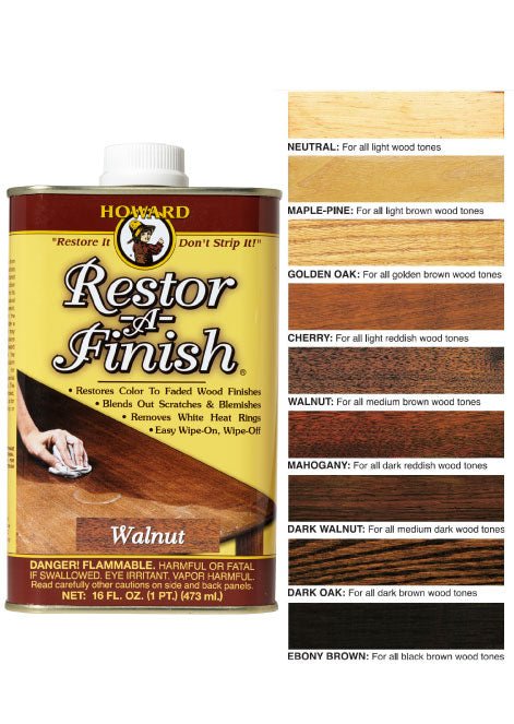

F1nut will disagree, but you can simply do a light sanding and use Howard's Restor-A-Finish. I have done this successfully on a bunch of different speakers.

Be aware that if you use Howard's the manufacturer advises not to use any other finish over top as adhesion will be compromised in future repairs or refinishing.
Lucky Pierre is correct, I will never recommend any Howard's products.
