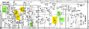

Hi tcdriver, I'm kind of hoping you are still watching this very very old thread. It is not nearly as old as my KA-6000! Or me. These two things are very close in age.
Anyway, I'm working on my KA-6000 and keep referring back to this thread, and some others that you chime in on. I'm trying to follow the schematic and identify all the caps in the "signal path", and/or coupling capacitors. I guess my first question is if these two things are one and the same?
But more specifically... you mention C327/C328, but I'm assuming you mean 927/928 since they are on the amp board. I know, I know, you wrote this 16 years ago.
Moving on... I'm trying to come up with the "seven coupling capacitors per channel between the input of the tone amp and the output of the high pass 40Hz" in your first post. I'm counting more. I've hightlighted what I think are coupling capacitors and come up with nine (9). Which ones are not? C702/C704?

Then I come to the main amp board and have the following questions...
Wouldn't C907 be a coupling cap?
C927 runs to ground. See above I thought maybe a typo but if you meant C927/928 in your post then I would like to understand why this is listed as coupling cap?
C171/C271 aren't these the big coupling caps? Maybe I'm not understanding their role.

To better understand the coupling, try overlaying the DC voltages
C702/704 are not coupling caps. They are probably part of the filter circuit. .22 is too small to couple without significant signal impact.
C171 is an output cap. Essentially it is a coupling cap, but bigger to accommodate the additional energy needed for the speaker circuit
Thank you, Semanon. Very helpful so far. Looking at it now and it's starting to come together in my mind I think. Basically it looks like most if not all CAPs with a listed voltage, even if kind of low such as 3.15V, are either in the signal path or a bypass cap, is that correct? So in the head-amp, C401, C409, C405, C407? and Pre-amp C502, C508, C522, and C526? Its seems all the other caps are very small and non-polarized and I can drop a small film cap in there to replace either ceramic or mylar. Let me know if I'm on the right track. Thanks again!
