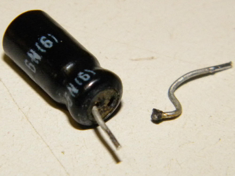

It's also possible that a device in the path has an internal connection problem. I recently discovered an electrolytic with an internally failed connection - It let go well up into the package:
