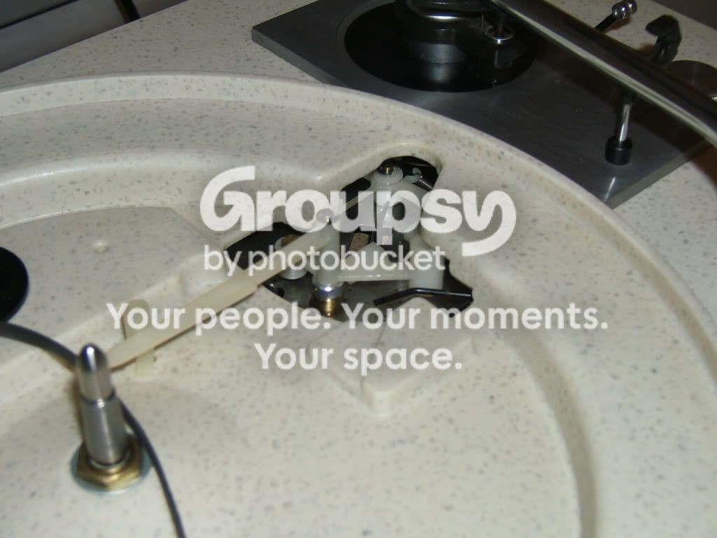

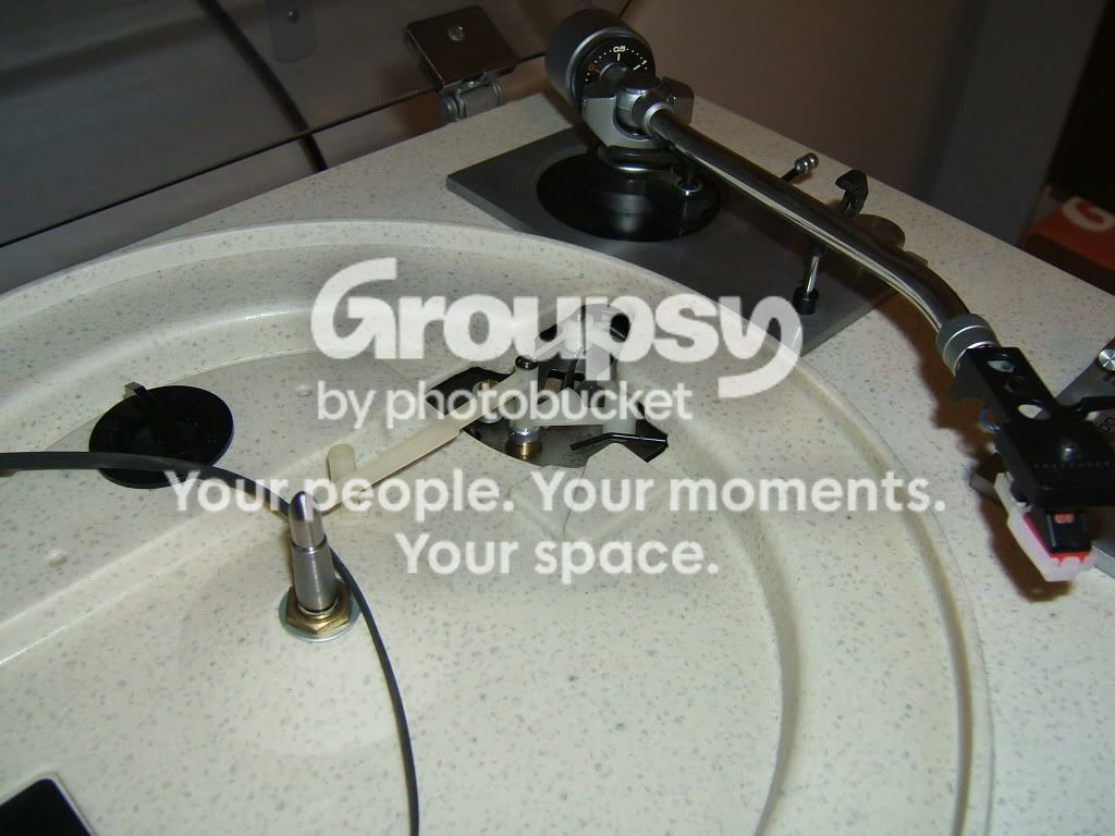

rang, take the platter off, there should be a small pin in a white plastic 'nut' on the backside of the platter. This trips the long lever seen in the second pic that returns the TA.
Move the play lever to play and trip the lever by hand(pull it towards the front of the TT) and insure that the mechanism works. HTH, Preston

yes this is all there.... and I when I do this by hand the TA picks up like it should.

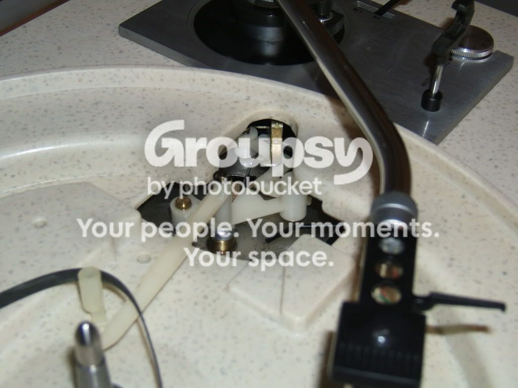

if you look at the second picture you posted you can see the metal detecting operation arm. is that tight or loose? On the TT it is very loose and when the TA hits this it does nothing at all.
this is what it looks like, if you look at the first and second pictures you can see where the TA arm hits the detecting operation arm. Is this lose or tight?

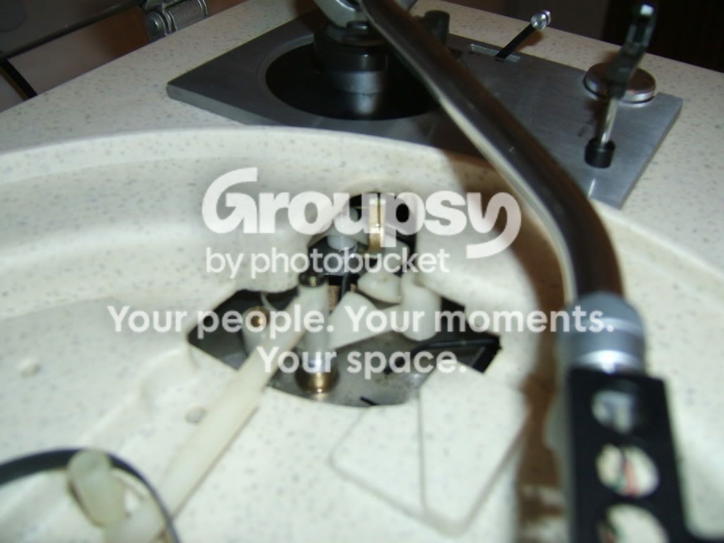

rang, after looking at your photos closer I see where the problem is...you are missing a part or parts that work in conjunction with the dectecting operation arm.
I've taken a quick pic for now and if we need more I'll do that tomorrow in the daylight.
See that curved, kinda like a backward question mark shaped white plastic piece to the left of the detecting operation arm? That is what your missing. HTH, Preston
