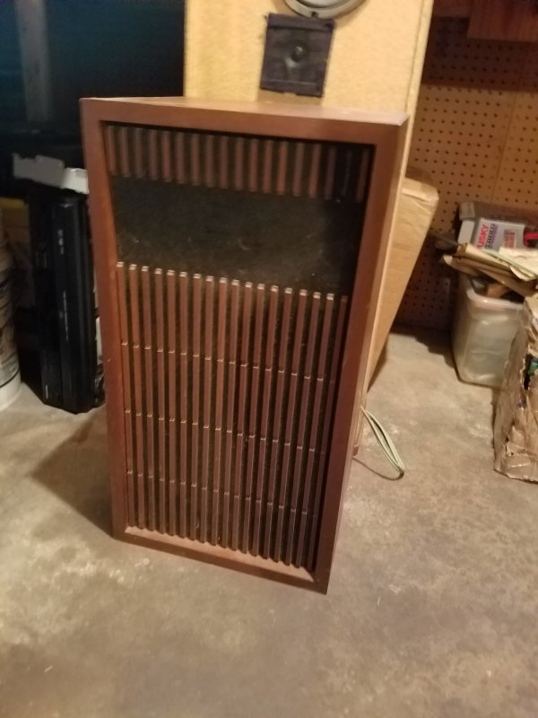

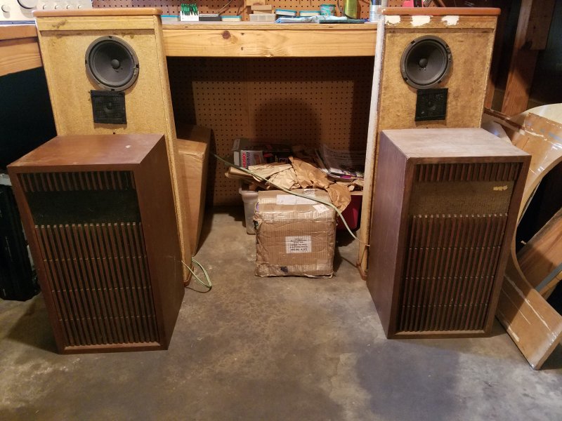

Picked up a pair of KLH Model 6s today, what can I say, I'm a sucker for anything Henry Kloss designed. All drivers work but caps are original, so they'll have to go, and the surrounds need to be redoped. I Listened to them for about 10 minutes and was really impressed especially with old caps and leaky surrounds. The one thing that's got me baffled is the grills on this pair. I've never seen a pair with grill like these before on a pair of KLH speakers. If they came off some other speaker they sure do fit well. Anyone seen this type of grill on a pair of 6s before?
Those are KLH grills and fairly rare! They look great!

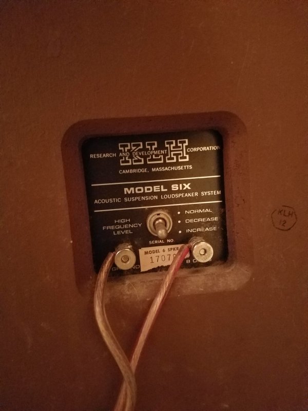

What are the serial numbers and can you post a pic of the backs?

Those are neat, esp from a historical perspective. Looks like KLH may have been concerned about the wood strips blocking the high frequencies. Good call on their part. The gap in serial numbers must mean they made more than a thousand of them?
You guys are no fun. I was hoping to hear that these weren't the right grills so I could just put some new cloth on them and be done. I guess I'll have to figure out how to restore them.
Yea, the grills come off fine. The fabric on one is badly faded, the other is not bad, but it is missing one of the short wood pieces that go across the top. Making a new wood piece won't be hard, but getting the wood pieces off the fabric might be a pain. I was thinking about trying a heat gun or an iron. Then getting the spacing right when I glue them to new fabric will be a slow process.
Very Nice! I have seen those before, but not often. Most likely those were an optional grill that dealers must have ordered in along with the regular cloth. Based on the serials, those are fairly late in the KLH production run. Are the cabs the vinyl faux veneer? I'd love to find a pair of those. The WAF would go way up!
