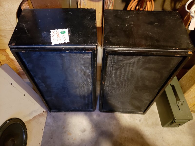

On FaceBook Marketplace, someone had listed a poor quality photo of free items on the curb in front of their house, and besides an old tube TV, there was a pair of speakers that looked like a KLH cabinet. It was impossible to tell, but they appeared to be either Model Seventeens, or Model Twenties. I messaged the person for the address, and hurried to pick them up. I found them in fairly good condition, with a chipped corner and both missing badges. Thus began the refurb. The cabinets were treated with Howard's Restore-A Finish, but the grills were stained and one had what appeared to be pencil marks on it. I investigated new grill cloth, but I wanted to keep the cost down. Instead, I used acrylic craft paint that we had laying around. I matched the color as closely as possible, and thinned the paint a bit. I did not allow the paint to enter the pores of the cloth, but rather used a dry brush technique, applying just enough paint to hide the marks. It did not stiffen the cloth or compromise the sound at all. Next on the list was adding binding posts. I wired them into the RCA type plug so either can be used. I also ordered replacement badges, which match very well and are high quality with an adhesive backing. Then I sealed the woofer surrounds with the proper Vintage AR sealant, which I had left over from a Model Twenty Three project. Finally, I cut off the ends of an RCA cord to plug the potential air leak from the connector on the back plate. I chose not to recap, because the tweeters sounded good as they were. I'd love to hear opinions on the sound from owners of this model.

I owned a couple pairs of the Seventeen, 8 ohm brother to the Twenty.
The original caps are typically completely used up after 40 years. However
good they sound, it's very likely the mids and highs will sound better with
new ones.
Otherwise, they are a sweet-sounding system.

Very nice work and save! Would have been a shame if these ended up crushed and in the dump.
As Rx mentioned, a recap is in order, and resealing the woofer surrounds is equally important for proper bass response.
eBay seller "vintage-ar" sells the correct sealer, which was developed and tested by Roy C., to be as close to the factory sealer you can get. To check if your woofers are properly sealed, gently push the cones in and release. If they return to neutral position slowly, you're good. If they spring back immediately, air is passing through the surround fabric and it needs to be resealed.

That’s exactly what I did when I restored my Twenty’s - recap, reseal, refinish. Well, mine are the Twenty-Plus version that came with the tulip bases and the console unit, but they are basically the same as the normal Twenty. I have some pics and sound-bites during testing here: https://imgur.com/a/EdL2D
I think they sound pretty ok actually.

Hey Glenn, you must have missed this part of my post: "Then I sealed the woofer surrounds with the proper Vintage AR sealant, which I had left over from a Model Twenty Three project." I have done that with a pair of Seventeens and Twenty Threes, so I was aware of the need to reseal. To me the Twenty sounds very similar to the Seventeen. The Twenty Three is a larger cabinet with a bigger overall sound and more bass. I'm glad I saved these classics!
