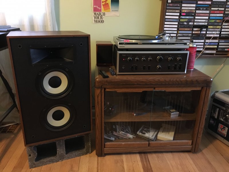

Hello all, this is my first post. I've been a lurker for years and decided to make an account as I’ve been making some advances in my setup lately.
I scored a Sansui AU-7500 recently, which I love the sound of. I’ve been using it with some less than ideal Ohm Model E speakers, which just sound OK. However—I was able to grab a pair of Klipsch KG-4s in great condition, but with blown tweeters for $100 on craigslist. I have a pair of crimes diaphragms on the way and will have them up and running soon.
My question regards the combination of this amp and these speakers—I’ve read of folks blowing the tweeters by clipping lower wattage amps. Though the Sansui is 38WPC, it seems very loud to me and I have no need to turn it up past 10PM or 11PM, even with the inefficient OHM speakers.
I’ll post some pictures in the next few days when I get the Klipsch KG4s up and running.

Just got the Crites diaphragms installed, took only about 20 minutes. They came with a yellow paper sticket/divider/gasket type thing. I left that on and installed as is as there was no reference to it online?
They sound great! Really pleased. One thing is though, I've had to turn the treble down to either -2 or -4 on my Sansui... the high end was incredibly present. It's possible I'm just not used to the brightness, but it seemed extreme to me.
Another note/question--without the Sansui's Low Filter IN, the woofers were moving an alarming amount on the intro silence to a track. I suppose I didn't notice the turntable rumble when I have Ohm E series speakers because they had essentially no bass response. Any ideas on how to combat the rumble other than this switch? It still sounds good without it but I'd rather not have to use it.
Here's a shot before I but the grills back on. So far I've only tested with rock records... Big Thief's Masterpiece from last year, and the Albini Mix of In Utero. :)

- you can control the treble with toe-in angle; turning the speakers outward a little to focus behind you will reduce treble, hottest is when you are looking directly into the horns and can see the back of the throat
- in the photo your speaker is really close to the turntable; some added distance may reduce potential rumble / feedback
- turntable on the amp looks great but the amp really needs about four inches of clear air above it to ventilate as designed

Great--thanks for the info! That makes sense regarding the angling of the speakers. Either I've gotten used to it or the highs have tamed themselves from the initial install--these things sound incredible now. They are incredibly fine looking pieces of equipment.
I'm moving soon so I'll find a better setup re: turntable location to reduce rumble and give the amp some breathing room. Good information to have re: the bass boost as well.
