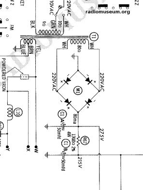

its about the damn selenium rectifier. I put up a real dumb question about it creating a different thread, I should have just googled it, and it created a massive lengthy awesome deep discussion. so I wanted to add to that one and as it fits. but here it is see pic. I think a wire is missing. there is no wire attached to the negative terminal on the SR, isnt that required?
