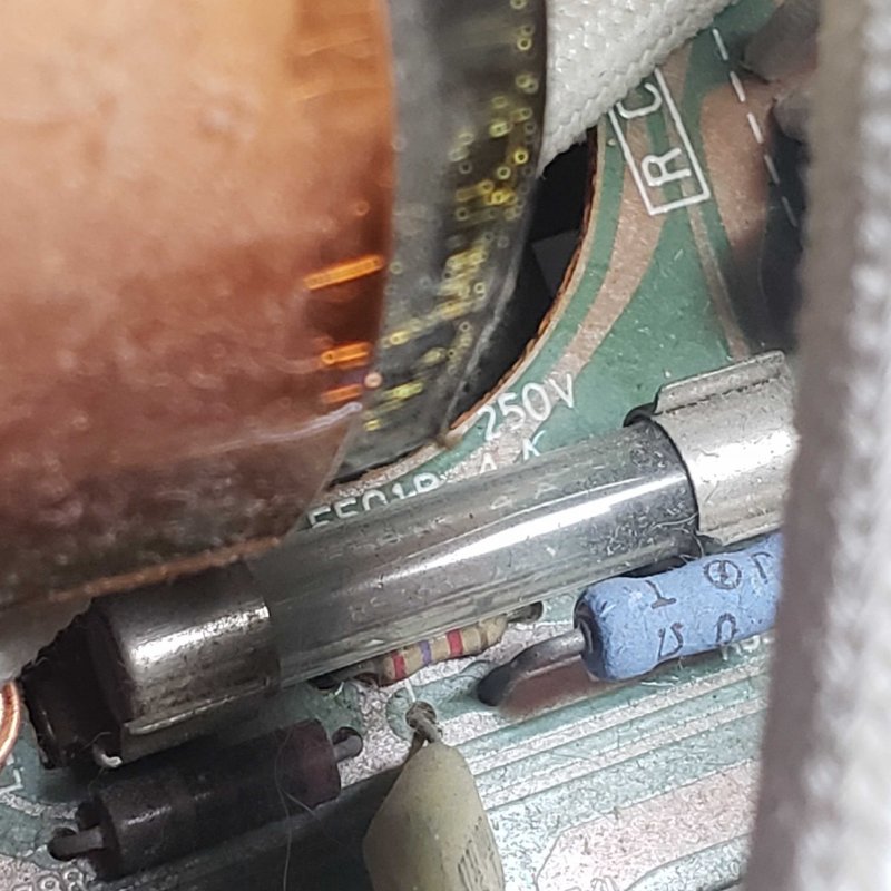

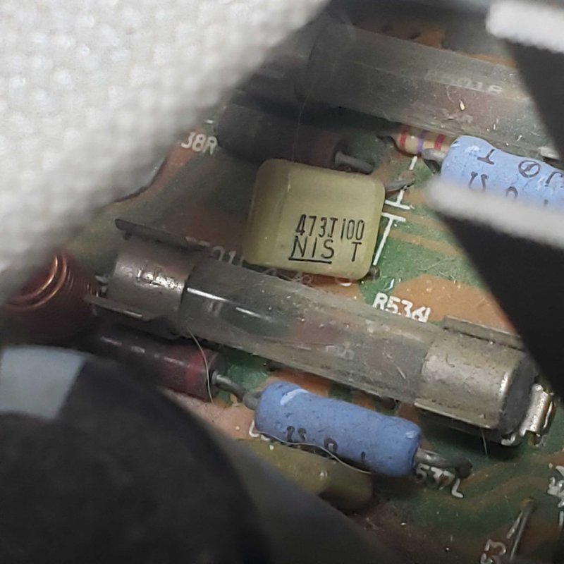

Thanks @cademan I got brave and cracked open the unit. I can see a few fuses and neither of them appear blackened. You reckon I could try to replace both fuses myself? I honestly think having a tech look at would probably cost more than the unit is worth.
Got any pics? One of those has to be the main power fuse but if you can't tell if they are bad by looking at them then you would need to take an ohm meter to them just to make sure as sometimes they break inside at the ends.

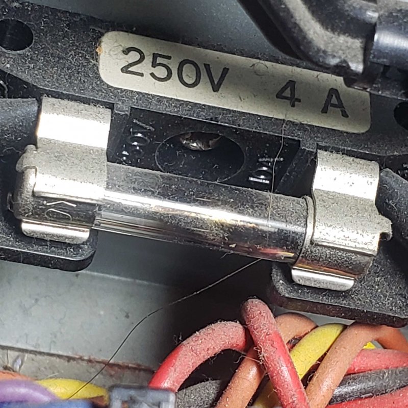

@cademan I believe the fuse labeled 250V 4A is the one associated with the power switch. It's separate from the other two fuses and nearest to the switch.
Maybe its just me but the first one labeled 250V 4A looks suspect. Worth a go. Do you see any other caps that may have given up the ghost? And just for giggles, have you tried Deoxit on the power switch ?

don't waste new fuses they are sure to blow pretty quickly . and possibly make things worse . the short circuit needs finding and rectifying first .
First pic looks iffy to me also but the second pic really looks bad (too me anyway). Could be the light or the way the picture was taken but I would check both.
Sometimes fuses simply fail, but most of the time they fail because they are doing their job of protecting stuff.
