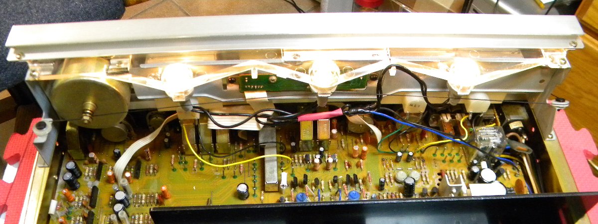

I just tried these in an SX-780:
While they fit, they were quite tight. I applied silicone grease (clear dielectric, not heat sink compound) to the cones to allow them to slip into the light bar. Once installed, the fit was so tight that the side leaves of the contacts would not permit the wedge base lamps to be installed. I cracked the corners of two lamp bases in two different sockets trying to install them. There is no hope of installing them with the lamps in the sockets since the bulb will not allow the cone to collapse sufficiently for installation. It's necessary to install the lamp after the socket is in place, and remove the lamp from the socket before removing the holder from the light bar.
A little trimming of the retention detent with an X-Acto knife was all that was necessary to relieve the contacts enough to permit lamp installation, but the lamps still need to be installed after the sockets are in the light bar.
I'm not sure if the light bar openings in the x80 series is different from those in the x50 series, but they will fit with some work and are still a LOT easier than automotive side marker lamp sockets.
LED Bulbs with these new bulb holders
I decided to try some of these bulb holders too.
I was surprised and happy to discover that they were slightly deeper than the stock plastic holders and actually allow LED bulbs to be installed. All the previous LED bulbs that I have tried were too tall and when the "bonnet" was installed it pressed down on the head of the bulb and broke the plastic bulb retainer.
One more thing, I installed 12vdc LED bulbs in the ~7.5vac sockets and they worked perfectly! I am aware that LED bulbs can be purchased as ac/dc types but these cheap LED bulbs from amazon.com seem to work fine at 7.5vac. At less than a $1 each they are half the price of a 168 bulb plus supposedly last a lifetime.

I have been running these ac/dc 9~14v LEDs in my SX-1280 for over a month at 10 hours a day and they are fantastic from my point of view.
The illumination is even and they present a look that to me just showcases the Silver Faced Pioneer receivers dial. Downside is price, around $7 each IIRC.
The rubber bulb holders that you posted took care of the ceiling height issues I had previously. Before that I would router out a small area in the underside of the bonnet for clearance. It worked but was time consuming and too exacting.
