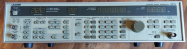

I just finished repairing my second Leader 3216 and could never find much info on them so I thought I'd post a quick summary for anyone searching.
I purchased my first one off the auction site a few years ago as a working unit, but it wouldn't boot up when it arrived, so the seller gave me a very healthy discount to keep it. I contacted leader and they sent me all the manuals they had, which was very helpful. Basic troubleshooting uncovered 2 of the 4 power rails were dead - the +15VDC and one of the +5VDC. Neither rail was shorted, so I surmized the regulators were bad - testing confirmed this. The 7815 regulator is located on the right side of the frame and connects to the main PCB by a wire harness so it's easy to replace. There are 2 - 7805 regulators - one next to the 7815 and the other mounted directly on the main PCB. My dead one was on the PCB so it was not as easy to replace, but the board has connectors so it comes out pretty easily, although desoldering is a bit of a challenge. With both of those replaced, the unit fired right up and frequencies/output levels were all spot-on. I've been using that one ever since with no issues.
The second 3216 also came from the 'bay but this one was sold as 'no output' 'needs repair' and was priced attractively because of that. Knowing what I did about the first one, I took a chance on it . . . This one only had a dead 7815 regulator so a quick, easy fix. Like the first one, the frequencies and voltages were all correct . . . . now I have 2 which is probably 1 too many, but . . .
FWIW, I communicated with a guy a while ago who repaired his non-functional 3216 by "replacing a couple of resistors on the RF board that had drifted significantly". He mentioned that they were located near a transistor that runs hot but didn't provide any more details.
Hope this helps someone.

I thought I’d share my experience with a Leader 3215. To add to the knowledge here a bit.
For those who may not know, the 3215 does not have built-in stereo modulation — it requires an external stereo modulator when that function is needed.
I picked this one up at an estate sale of a ham radio operator (of all places) and was surprised to see it there. After bringing it home and powering it up cautiously the way one should with old equipment, it worked perfectly right out of the gate.
Several months later it simply quit. Investigation showed a shorted main power transformer. The fuse was still intact, so the transformer had apparently drawn just enough extra current to cook itself without blowing the fuse.
I recently decided to try repairing it rather than hunting for a replacement (and taking the chance of getting another marginal unit). Further troubleshooting revealed that a shorted tantalum capacitor on the input side of the remote-mounted 7815 regulator was the real culprit. That short had overloaded and destroyed the 18 V secondary winding of the transformer.
Instead of buying an entire parts unit just for the transformer, I ordered two individual transformers from Mouser and modified the layout to fit them. The input voltage to the regulators is higher than what the schematic indicates, so I ended up choosing a higher VA rating than necessary. It’s still well within the regulators’ ratings, and after hours of running on the bench nothing is getting hot.
Space is tight, but I got them in. I had to relocate the input filter to the center area just below the GPIB connector.
Next up is dealing with the battery on the CPU board. I’m leaning toward simply removing it and leaving it out — I don’t really need the memory/preset function, and that eliminates one more potential future failure.
Heads-up to anyone working on one of these: you might want to proactively replace those tantalum capacitors.
Steve
