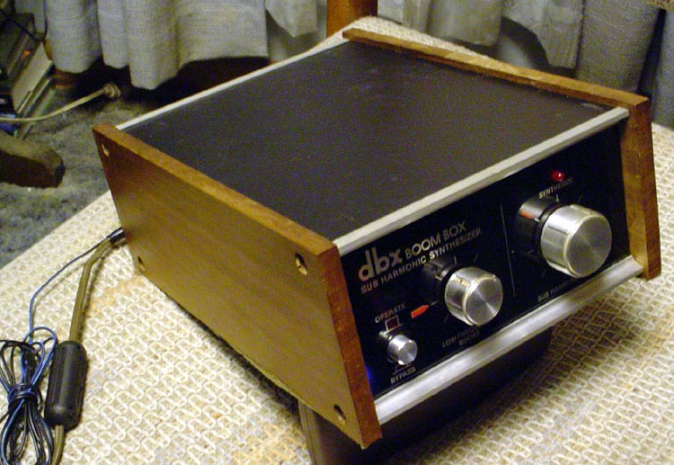

Betcha you could REALLY have fun with one of these ...
The red lines on the controls are just that ... anything higher (lower?) on my system, and things start to melt ...
