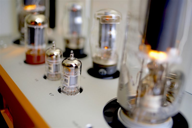

After some years of upheaval I've managed to unbox some gear I've had waiting for a new home, one of those being the Line Magnetic 518IA SET. This amplifier has me thinking about the hierarchy of just how much of your funds you should allocate to each part of that chain. Source, Amp, Speakers has always yielded the best results for me but the stuff this amp is unearthing from my Audiolab 8200CD is amazing. Synergy with the KEF's is pretty good and the tonality, power and soundstaging abilities of this combination is close to the best I've heard of any system I've owned, certainly the best I've heard from CD, images simply leap out of the LS50's. Volume level is not a problem although I have noticed that not that much happens after the 10'o clock position is reached, but given that I'm in a small space the output is more than sufficient. I've also used the CDP with my favourite Creek Destiny 2 thats been a solid performer for many years as well as the KEF's. To be honest the latter didn't work well together with the bass being overpowering in my 11 x 10 room, I resorted to using the foam bungs as the midrange was taking a beating, the Creek and my Epos ES11 are far happier together.
Like so many things Hi Fi this amp isn't perfect. There is a lack of deep bass, driving the LS50 with the solid state Creek produced more extended upper bass. One of the things I've never seen mentioned in reviews is bass speed and it does appear to be a little lazy, lagging behind the midrange and treble just a hair. This could be down to the amp speaker combination though, driving a more sensitive floor stander might give better results than the KEF's at the lower end.

You can extract more bass from the 518 depending on which driver tubes you use. If you can get some RCA black plate 6L6GCs, those would be best. For a budget, try the new Tung-Sol 6L6GCs, which are also quite good for the money.

I drove the LS-50 for quite some time with my LM219IA and I have auditioned the LS-50 on a number of 100watt + SS beasts.
My main recommendation these days to most people is to do your best to try and buy "synergistic systems" which as an Audio Note owner (system approach) always made logical sense. But the brand doesn't matter - what matters is to buy an amp the speaker maker designs for. KEF didn't design this loudspeaker for SET amplifiers (or tubes for that matter). This is obvious when looking at the measurements or even the spec sheet.
So as an end user, you, are probably better matching with an appropriate amp. SET amplifiers are wonderful - my favorite, BUT their biggest Achilles heels are 1) lack of power and 2) lack of power into varying/low impedance loads. That's why it generally takes rather massive ones to be able to competently drive speakers like the very VERY difficult to drive KEF LS-50 properly and even you are finding it still has trouble.
The KEF is low sensitive AND it has a low and varying impedance load. King Ip of KingKo audio brought the KEF to his store to be a demonstrator speaker and he dumped it almost right off. His amps can't drive them properly even in a small (and I mean very small bedroom sized room).
The 219IA with massive transformers drive them well but I still would not drive them in a larger medium room or larger. And it still wasn't an ideal match by any stretch. Part of this is the lack of damping factor in SET amplifiers. More damping factor = more negative feedback = worse sound. But high damping factor has more driver control into low impedences which is where bass is. Tube changes won't fix this either.
Now of course I am probably far pickier than the average bear (and about different things) and because I generally dislike SS it is a difficult task to find an amp for the KEF. But for the KEF - a larger push pull amplifier in the 70 watt+ range and on the 4 ohm tap is what would be needed. You should have the KEF running from the 4 ohm tap on the LM as well if it is not already.
I guess what I am advising is not to try and shoehorn an amp into a speaker not designed for the amps. For example for $1,995 I would prefer the Spatial Audio M4 which is also 4ohm min 3 ohm but is supposed to be fairly stable. And it is a full ten times more sensitive making it significantly easier to drive.

Simplistically - tweeters in loudspeakers do not like distortion and if you run a low watt amplifier and push the amplifier into high distortion (clipping) it is possible to blow the tweeter(or the woofer or both but usually the tweeter goes first). The reason high watt amps are less likely (but still possible) is that they will not likely to be pushed into "clipping" and won't send high distortion signals to your loudspeakers.
Low efficiency loudspeakers also tend to be low impedance at certain frequencies - so let's say you are driving the KEF at 90decibels and you have a 10 watt amplifier. The speaker is 83dB sensitive and
83dB requires 1 watt
86dB requires 2 watts
89dB requires 4 watts
92dB requires 8 watts
95dB requires 16 watts.
So you are trucking along no problem but all of a sudden you get into a crescendo (loud bit) in the music and if that occurs in the bass where the KEF dips to 3 ohms then the speaker asks the amplifier for more than double the power. The KEF is rated as 8 ohms but in a bass passage it drops to 4 ohms or less thus it asks the amplifier for double the power to reproduce the lower frequency.
So for the KEF speaker to reproduce 92dB at 4 ohms instead of using 8 watts that it was using it now requires 16 watts.
The amplifier immediately clips (because it can't reproduce 16 watts it can only reproduce 10) and then sends distortion to the speaker.
Most speakers are pretty tough and can take a fair amount of distortion for short periods (and amplifiers can often reproduce more power than rated spec for short duration but then - not always). Many tweeters can handle about 10 watts of distortion. Which, weirdly enough can make very very low watt amps safer because they can't send enough distortion in watts to damage the speaker. A 3 watt SET can only send a total of say 5 watts of distortion (if it can go 50% above rated spec) to the speaker so if the speaker can handle 10 watts distortion it can't be blown by a 3 watt SET. Well so the theory goes - I am not about to test that. :)
The other issue is that not every amplifier is designed equally - some are simply built better where the rated output is across all frequencies while others are rated only for 1khz. Some can go above their rated output in short duration while others don't meet their rated spec. So some 8 watt amps may only be 4 watts in reality and other 8 watt amps may reach 12-16watts.
Having said all that, SET amplifiers sound so darn good they tend to make every speaker sound a helluva lot better regardless of the sensitivity (if you can live without high volume). BUT, it's not an ideal match and it can cause damage if you turn the volume too high. If you hear distortion turn it down.
