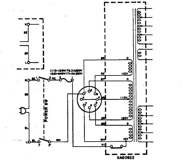

That schematic is the General version not the US version so there could be differences. If it doesn't have multiple input taps step down transformers work well.
I wish it would have multiple inputs yes but in my case it hasn't. This is the one I'm looking for (the ones used in AUS and JAP are the same):

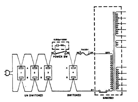

But this is what I have:
