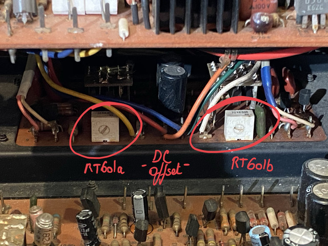

I manage the adjust the DC offset to 0V (before= 0.5VDC on the right channel :dunno:.

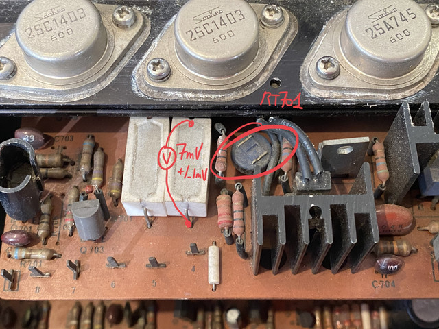

However, I am struggling with the Bias adjustment.
I do not know the target value and most importantly the 2 measuring points.

OK, I figured out the BIAS and other adjustments. This is a tentative list as I haven't actually done them as yet:
BIAS RT701 (Blue)
On Power amp board
Test across 0.22 Ohm 5W output resistors
7mV +/- 1mV for 32mV (27~36mV)
40mA max
Tested cold
DC Offset RT601 (Red Horizontal, all others vertical trim pots)
Under amps near DML 01 (Q601)

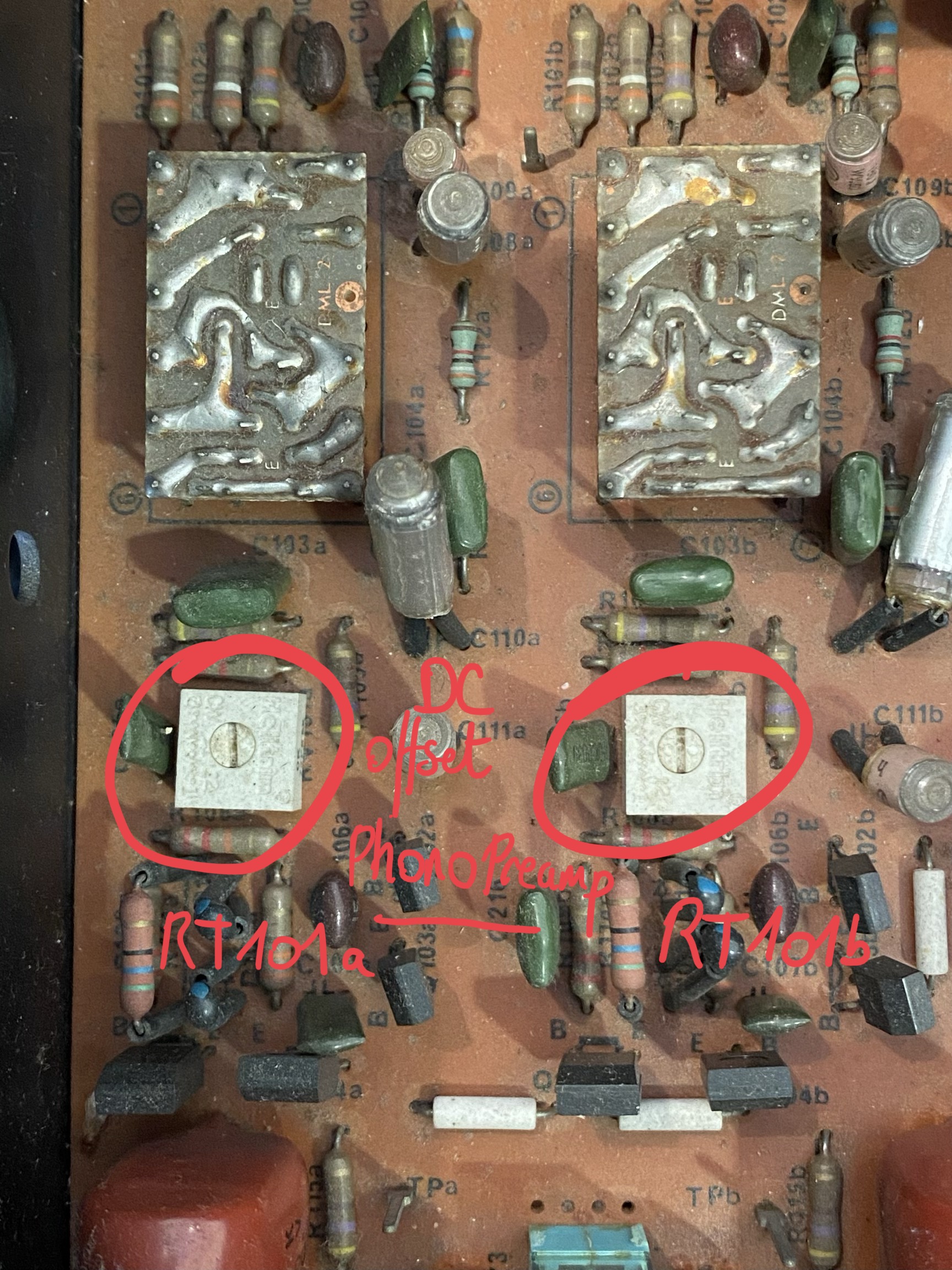

DC Offset Phono Preamp RT101 (Red) (I think this is what that adjustment does...more when I've tried it)
Left side of main board behind DML 02 (Q101)

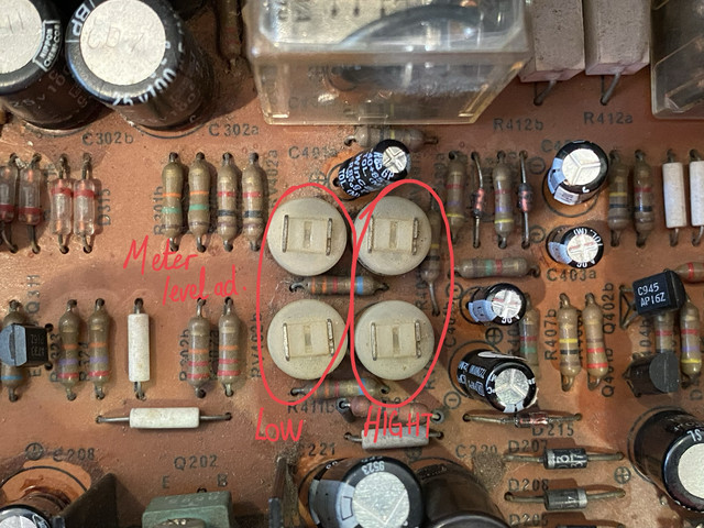

Meter level adjust High sensitivity RT 401 (White)
Meter level adjust Low Sensitivity RT 402 (White)
Do high sensitivity first
Cluster of four white trim pots right side of main board.

1. Dc offset for the phone Preamp, I did not touch it.

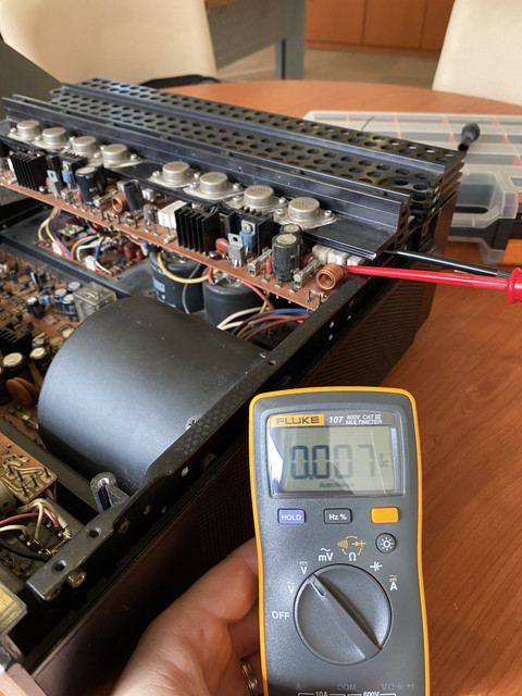

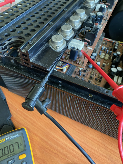

2. Bias adjustment
On Power amp board
7mV +/- 1mV for 32mA (27~36mA)
40mA max
Tested cold
3. VU meter level adjustment, I did not touch it !
4. DC offset

1. Bias Adjustment:
1.1: Left channel:
7mV :bigok:
1.2: Right channel:
7mV :bigok:

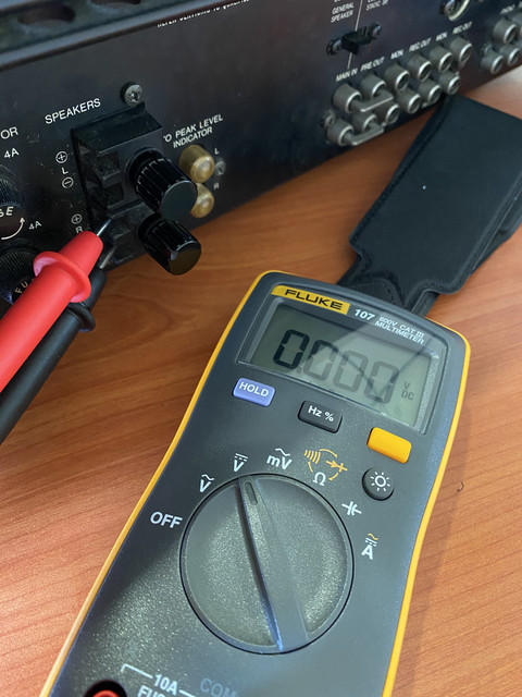

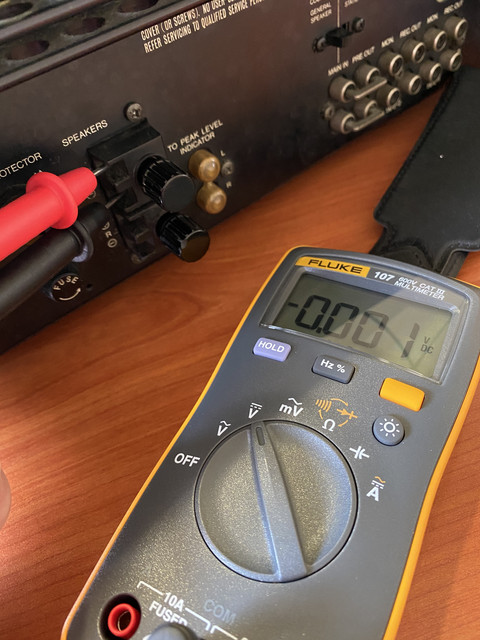

2. DC offset:
2.1: Right channel:
0VDC :bigok:
2.2: Left channel:
1mVDC :bigok:

Hi All, I'm refurbishing my 5L15 these days.
I've managed to get the bias and the DE offset as per the specs described above.
One question, how to set the DC offset for the preamp. I've located TPa and TPb close to the DML, I guess that these pins are where to hook up a DMM.
Any idea?
Many thanks!
Phil
Thanks Binkman, but the point here is that there's no SM so far for this amp, these pots are not the ones for the w/meters (w/meters pots identified elsewhere).
The preamp (I guess) pots are the ones shown hereunder (post #4)
Hi, I've tried to connect my DMM between TPa and ground and it looks like it's how it works...
Adjusting the pot, I can set the voltage close to 0V. I'll replace the pot by a multi turn one to make it easier....
It someone could confirm or give another explanation, welcome!
I saw TP a an b... , wonder what the other pin on top pic is? but if it works w/your test. How much off before you attempted adj.?
Around -150mV and moving when adjusting, going positive and negative, very sensitive, that's why I will install a multi turn pot.
I found the same method in another Luxman SM, same TPa,b , and decided to try.
The last ones are the 4 pots for the VM...but this requires to know the input level in mV to calibrate the VM
No info on the 5L15 out there but the 5C50 preamp has a similar offset adjustment and it appears the method used is the same as for that preamp.
