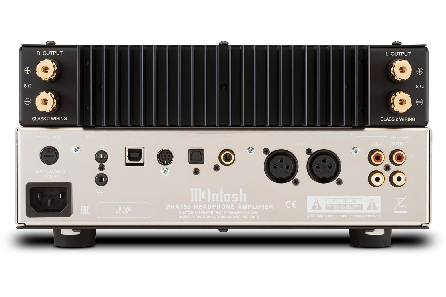

I actually seriously considered the MHA150, and yeah it has a sub output, but then for a number of reason I decided on the MA5300; well until recently when I discovered the 5300 has no 2nd set of pre-outs.
I decided against the MHA150 because it has only a bass boost option, not the usual bass and treble. It also lacks a phono section and I really don't want to buy a separate phono pre. And last, even for the smaller system, I really don't want less than 100wpc. I'm sure the MHA, typical of Mcintosh, has a very healthy 50wpc but that's just my personal hangup about minimum headroom and speaker options.
MHA150-Back.ashx
So do you mean that's further confirmation that SS amps are fine running with no load?
I wondered about that but also wondered if something about the design of the MHA allowed for operation with no load. I didn't want to assume it applied to all SS amps.
All Solid State amplifiers can run all day with no load on them. There is absolutely no danger to the amplifier at all doing this.
