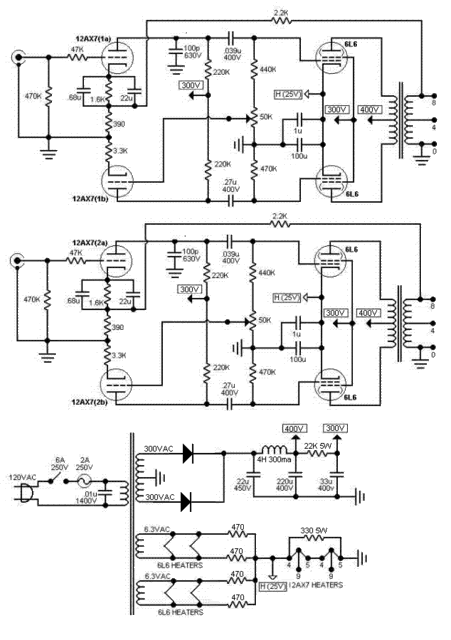

Hi the amp is about 12 watts a channel , you should change the ceramics to polly caps , they will sound better .Use the cap value from Gordons schematic fot the audio circuits
Schematic By GordonW

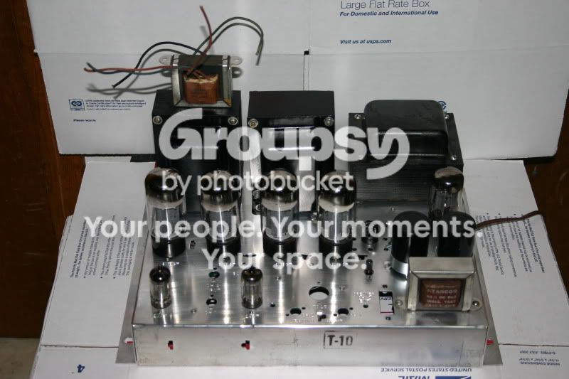

Photo of my 185 .

I rebuilt my 185 as a 175 with all new caps and resistors as well as brand new set of tubes with a vintage rectifier so I can't compare directly to the old stuff.

That schematic doesn't show 8 tubes, it only shows 6. That schematic shows the two halfs of the 6EU7/12AX7. On the schematic it looks like two individual tubes.
You will notice it says, "1A & 1B", "2A & 2B". This indicates the two halves of a single tube.
The power output tubes are the 6V6/6L6's. If your talking about the 5U4 rectifier tube, that schematic shows solid state diodes in the place of where the rectifier tube would normally be.
