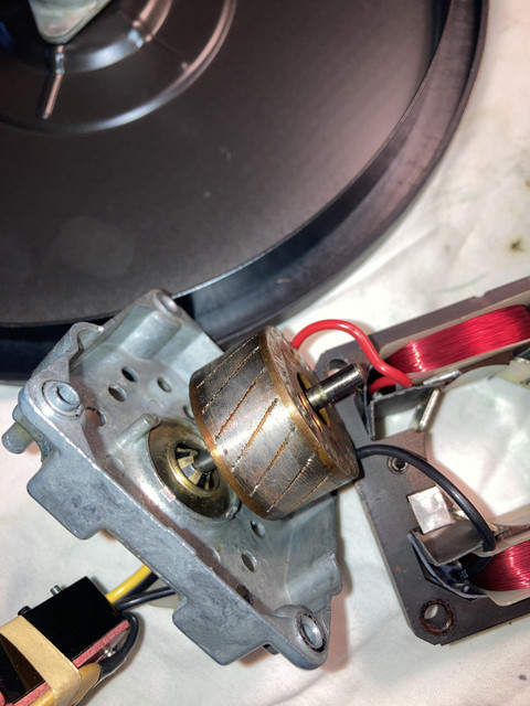

resurrecting this thread with a similar question -
I've disassembled the motor - but I'm not sure how to take apart the bearings or remove the top gearing to get in an clean the top bearing - any tips? Are these supposed to be disassembled? Or do you just flush them out with solvent as best as possible?
