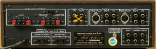

novice dans ce domaine, je rencontre un problème avec mon nouvel amplificateur Marantz 1070.
Seul le canal droit fonctionne ; le canal gauche reste muet, que ce soit au casque ou sur les enceintes.
Je me trompe peut-être, mais le problème pourrait-il provenir de la carte de préamplification PE01 ?

First, to verify that your problem is in the Preamp or Main Amp, you can perform this simple test.
  • Connect the L PreOut to R Main In
  • Connect the R PreOut to L Main In
  • See if the bad channel changes sides. If it does then the problem is in the PreAmp, if not then it's in the Main Amp.

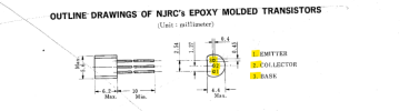

To measure transistor voltages, you need to measure the voltage at the 3 leads: emitter (E), collector (C), and base (B).
  • Turn the volume control all the way down when you measure the voltages,
  • Set you DMM to measure DC volts.
  • Black DMM lead on chassis ground. Red lead on each transistor lead.
  • Compare your measured voltages to those on the schematic.
Here are the transistor part numbers from the PL:
It looks like there are both NPN (2SC1328) and PNP (2SA763) transistors.

Transistor datasheets:
thanks for your help and reply, on my 1070 the jumpers of pre-main are wired and soldered inside. i don't have jumpers outside, it's righ for you ? i need to connect like you suggest with rca cable ? the both together L pre to R main and R pre to L main or step bye step first L to R and then R to L , thanks
I think the 1070 has built-in jumpers to internally connect the PreOuts to Main In.
When you insert an RCA cable, it will bypass the internal jumpers.
Just use a stereo RCA cable and cross-connect both L & R channels at the same time (with power off)
Then turn on the power and see if the same channel is bad, or if it changes to the other channel.
Let me know what you discover.
J'ai l'impression que la panne pourrait venir des soudures internes des jumpers. En effet quand branché les rca le canal à fonctionné à nouveau, en touchant un peu les soudures le son était par intermittence, une fois les cosses bien écartées le son est nickel. Je me demande si mon problème ne vient pas des soudures qui ont mal vieillies ?
Yes, there are two things:
  1. The internal jumpers are oxidized and need to be cleaned
  2. Wires soldered to the PreOut and Main In could have developed a poor solder connection.
There are some things that you can do:
  1. Get a can of Contact Cleaner or Deoxit D5 and spray the contacts inside the RCA PreOut and Main in RCA jacks
  2. If the wires are soldered to the RCA jacks, then get a soldering iron and some solder to heat and reflow the connections to the jacks
  3. If the wires are wire wrapped onto posts on the jacks, then try spraying contact cleaner on the wire wrap posts
