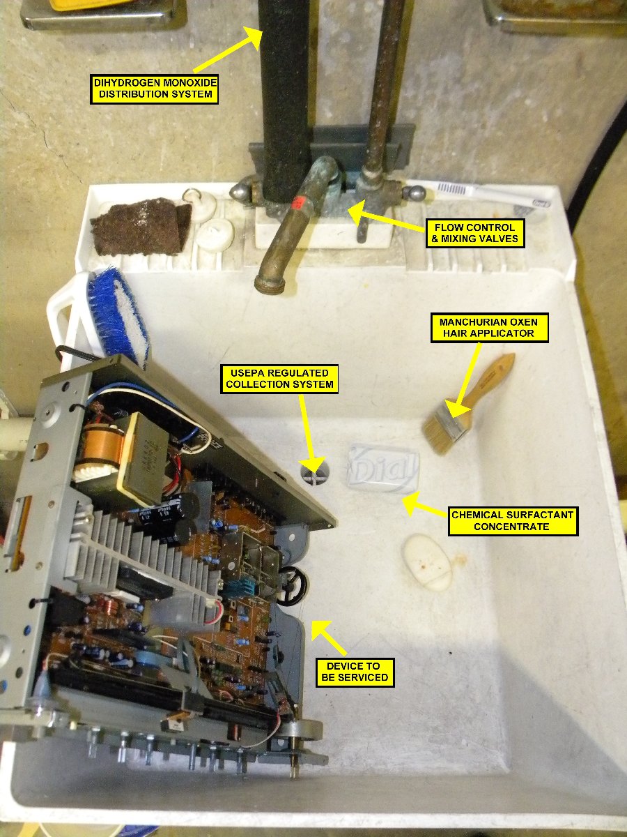

Watthour: what's the unit in the sink in your photo? Looks a lot like the Yamaha R-500 I've been working on.
