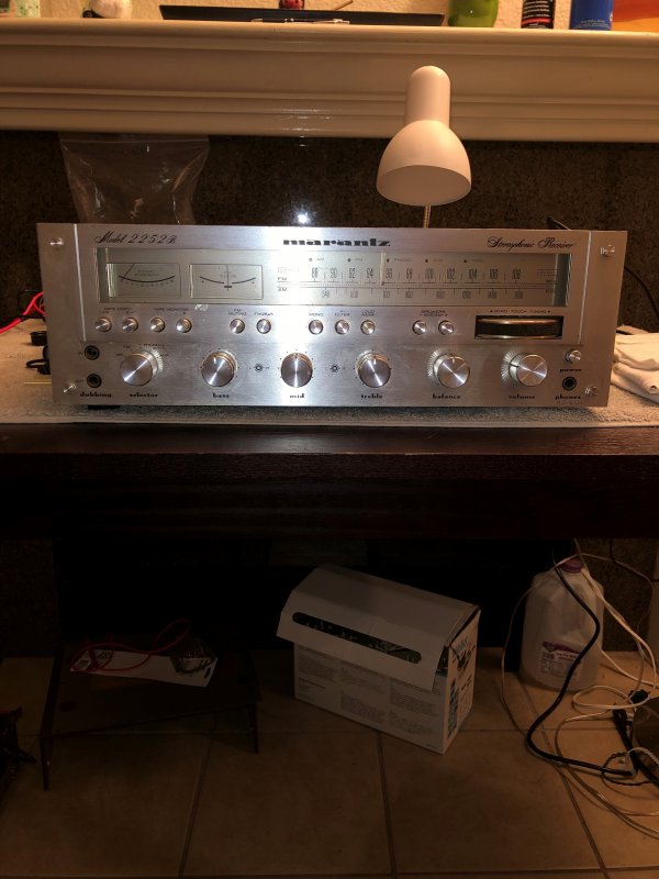

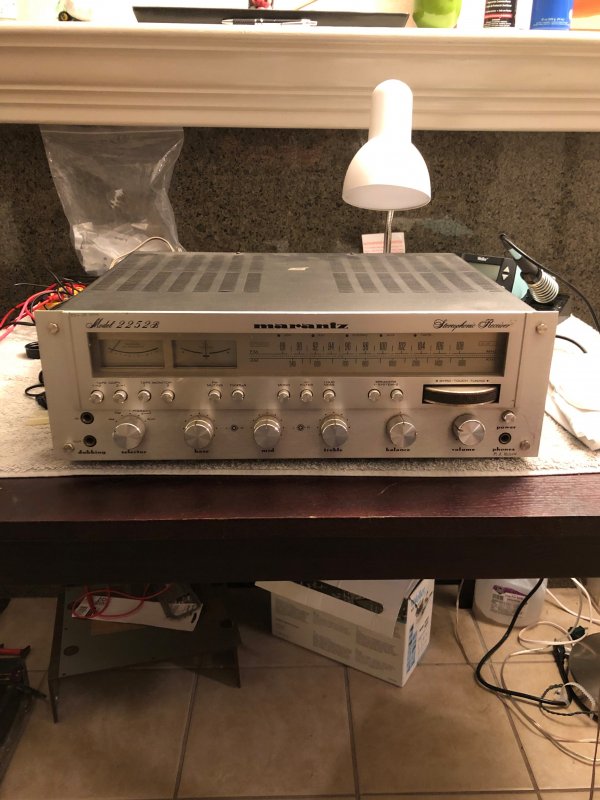

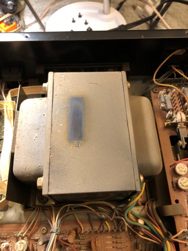

Hello all! Well I finally locally sourced a Marantz receiver and went and picked it up. Here is what I've got. 2252B with FM decoder cartridge installed. I bought it second hand off the original owner whose dad had owned it and who has recently passed away. I am going to be going through this unit and servicing it. Thank you in advance for all of the help. I had a couple of questions. First off, how do you remove the lamps? They seem to be glued in place from the factory with some kind of red glue. Will an exacto knife be the best way to liberate the lamp holders from the sockets? What do I use to re-glue? And LED's seem to be the only kit I can find on ebay, are these fine to use? I will post some pics of my progress so far. This thing was definitely in a smoking household so please be kind. These are the before pictures... this is the most excited I have ever been. :)
Lamp holders are soldered to the board if you're referring to the fuse lamps in the dial and behind the meters. Fuse lamps should pop out of the clips holding each end easily. Never run into fuse lamp glued in place.

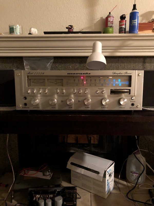

This is exactly why I Joined this site. For the wealth of knowledge that it possesses. Thank you from the bottom of my heart. I'll be honest. I was going to give up and just live with the darkness until you guys helped me. I am going to be surgically extricating these little lamp boards from their plastic bezels by using an exacto knife to cut the red glue of death and then since I have watched countless videos on the subject and they always seem to break the little tabs, (unavoidable on 50 year old brittle plastic), I will be using your little bracket method for placing them back into their homes. I love how it will be better than new using a mechanical fastener versus an adhesive one. I do not throw the term "genius" out very often but if the shoe fits, wear it! Thanks you guys. More pics to come!!!! :)

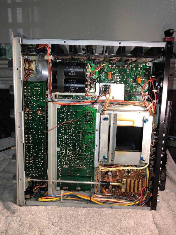

I serviced the controls and got the scratchiness out. I auditioned this receiver last night on the test bench on the JBL L-100 Century's. One word, wow. This thing has the lowest lows I have ever heard. Nice warm buttery mids and clear, crisp highs that seem to punch through the cloud cover and sing high into the heavens. I used to have an eq in my tape loop but it is not needed anymore. The FM decoder makes radio stations sound like an analog source and with an external antenna hooked in, this thing picks up every station there is. @ 52 WPC, 10hz-60khz, 0.05% thd, and a damping factor of 45, this is the greatest sounding receiver I have ever owned. :)

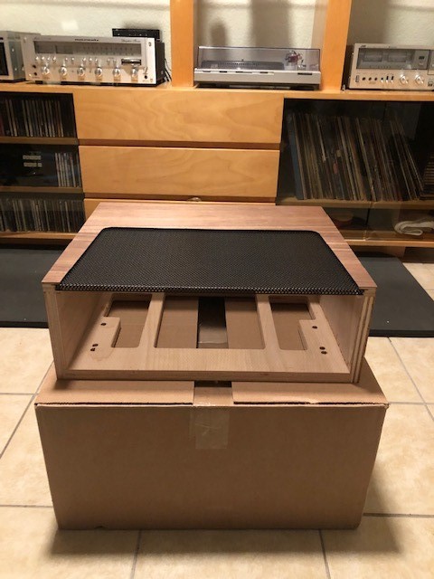

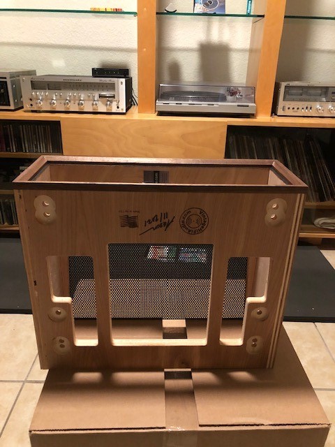

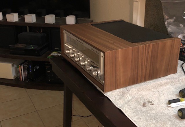

BTW, I have commissioned a wc-22 walnut wooden case to be built for this unit. AK has highly recommended member: Aaron99 to perform this build and his price is unbeatable. I cannot wait for this thing to arrive. I'm so excited!!!! :rockon:

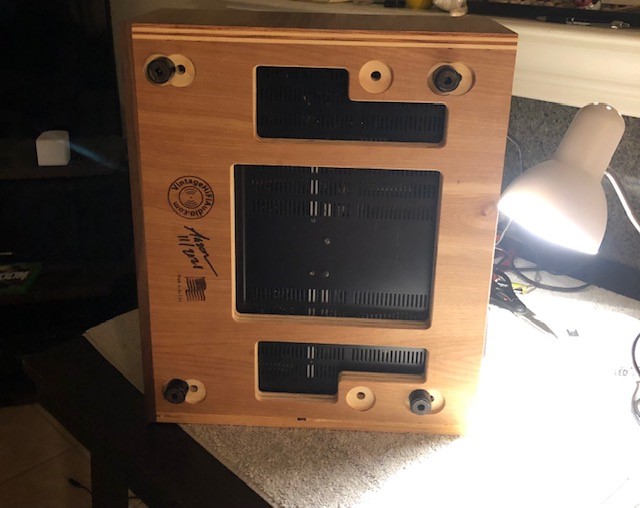

Here it is, as promised. As you all know, I commissioned a walnut case to be built for this receiver by AK member "Aaron99," and it arrived on my doorstep Thursday only two days after I ordered it! I cannot speak highly enough of Aaron's work here. It is flawless. The woodwork is stunning and all the wood grain matches perfectly on all sides. My house smelled like fine furniture oil as soon as I opened it. My receiver slipped right in and all of the bolt holes lined up perfectly. It even comes with longer screws to fasten the feet through the case and into the bottom of the unit. (Solid). Aaron is a super nice guy and is extremely knowledgeable on all things Marantz. I will order all of my parts from him from now on and I highly recommend that you do too. A used original case costs more than $300 and comes with all of its dings and scratches. Aaron provides brand new cases that will last a lifetime for less than $250.00 shipped. His price is unbeatable in this respect. Thank you so much Aaron. You have made my whole year. :)
