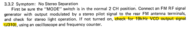

Also, the SM says:
Do you have an oscilloscope or Freq Counter or DMM that can measure 19kHz to check for signal?
You can also check DCV on each pin of H321 against the schematic.

Well, it didn't measure it. Probably the audio riding on it messed it up. I used a signal generator and it read fine up to 19kHz. Dang!!
I guess you're left with testing the parts that are in the 19kHz circuit off of the IC. I think that would be the pot of course, R311, R312 (16K) and the cap C305 (470pF).
Just an FYI for future readers, my FLUKE 117 meter (in AC/Hz mode) was able to read the 19kHz frequency on J310 to J312 (ground). Of course, these are not cheap meters but wanted to add this note to your thread.
